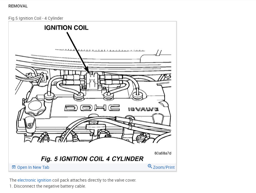

how do you get to the spark plugs, do you remove the fuel rail?
Dec 28, 2007 at 2:03 AM
I am attaching the process below on how to remove this. You noted this is a 4 cylinder and the spark plugs are accessed through the valve cover, so you just need to pull the four plug wires that are coming from the coil.
Here is a guide that will help with this:
https://www.2carpros.com/articles/how-to-change-spark-plugs
Below you will see what the engine looks like to help identify the coil and plug wires. Once you pull the plug wires you will just need to remove the plugs and the guide above will help with this.
Please run through all this info and let us know what questions you have.
