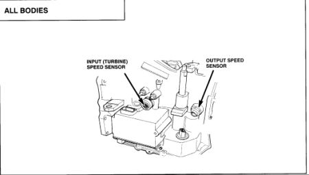

the other day i started my car and the spedometer and tach gauges were non responsive, and my digital odometer wasnt on. i checked the fuses but couldnt fine any that were blown (in car and under hood fuses). and before i tear down the dash and bezle i thought i'd ask around to see if anyone can help lead me in the right direction. thanks!

Sounds like a cluster problem, but it might be worth the cosst to have it scanned by a shop that can read "B" codes.

Hi Chris, Sounds to me like it could be the Output Speed Sensor. I would suggest replacing Both the input and output speed sensor they are less the $20 each. And I have found that 8 out of 10 times that is the problem.
https://images.2carpros.com/forum/automotive_pictures/188069_inputoutputsensors_1.jpg
