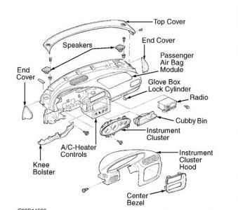

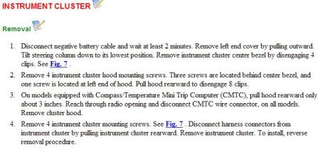

i want to change the lights on my 02 stratus gauge cluster. i know how to remove, but need specifics on the gauge cluster. will removing the cluster reset mileage? will it mess up the tach, speed, gas, temp?
Mar 26, 2009 at 10:43 PM
BLUELIGHTNIN6
  • 16,542 POSTS
Removing the cluster will not harm it as long as you perform the replacement procedure properly. Normally when you replace the cluster with digital odemeter you will need to have the odometer synced to your vehicle's computer. Since you are simply removing and installing the same cluster you will not have to do this. To help ensure you are removing and installing the cluster properly I have posted the correct procedures below. .
https://images.2carpros.com/forum/automotive_pictures/261618_Noname_368.jpg
FIG 7
