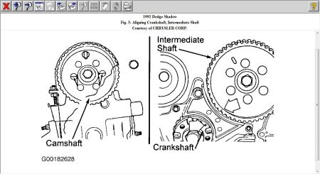

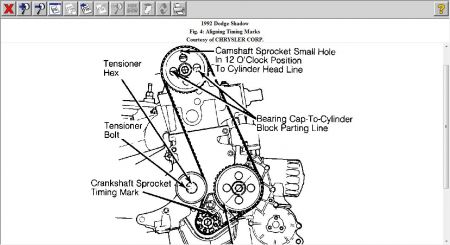

JOHNNYLAMB0967
  • 17 POSTS
with the #1 piston at tdc and the hole in the cam gear at the top they line up however there isn't any mark that lines up on the flywheel so what do you think that indicates. i couldn't get a fuel pressure guage..... thanks i appreciate you helping

  • 75,992 POSTS
What engine 2.2L or 2.5L?
Feb 3, 2009 at 7:21 AM
JOHNNYLAMB0967
  • 17 POSTS
2.2
Feb 3, 2009 at 3:32 PM
  • 75,992 POSTS
https://images.2carpros.com/forum/automotive_pictures/12900_camcrank_timing_marks_2.jpg
https://images.2carpros.com/forum/automotive_pictures/12900_camcrank_timing2_1.jpg
Feb 3, 2009 at 8:20 PM

okay everything lines up and since i cleaned the plugs it runs at a very low rpm with the gas pedal down 1/4th of the way but if i push it any further it stalls i am going to get a fuel filter now do you think i should get anything else to try b4 removing the fuel pump what about the fuel injector or the cam sensor or the crankshaft sensor or something like that
