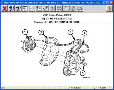

I am replacing the bearing hub on the driver side front. i have already loosened the 3 bolts that hold the hub on and cannot get the hub off. is the hub pressed on or is it just stuck in there real good. the truck is 4 wheel abs if that matters thanks

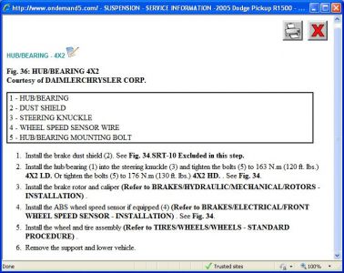

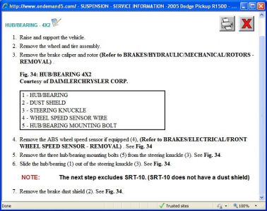

First of all thank you so much for your donation.I posted the removal instruction's for you so you can see you are right it just has those 3 bolt's holding it on.I would get some liquid wrench spray that in there let it soak for a while.Then i would get a hammer and try smacking it off you have a new one so you don't have to worry about hurting.Just stand out of the way so it doesn't hit you if it come's off suddenly.If that doesn't work you might have to use heat.
