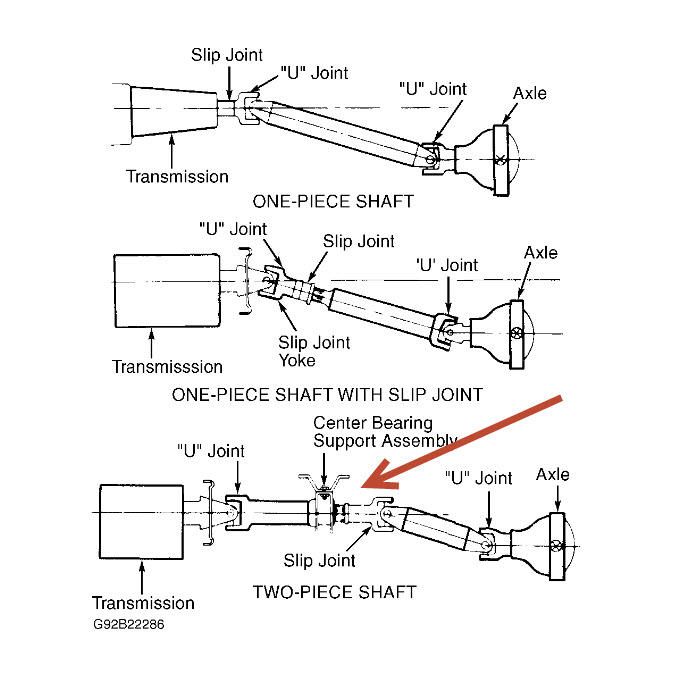

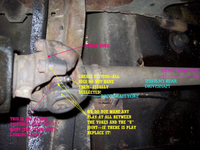

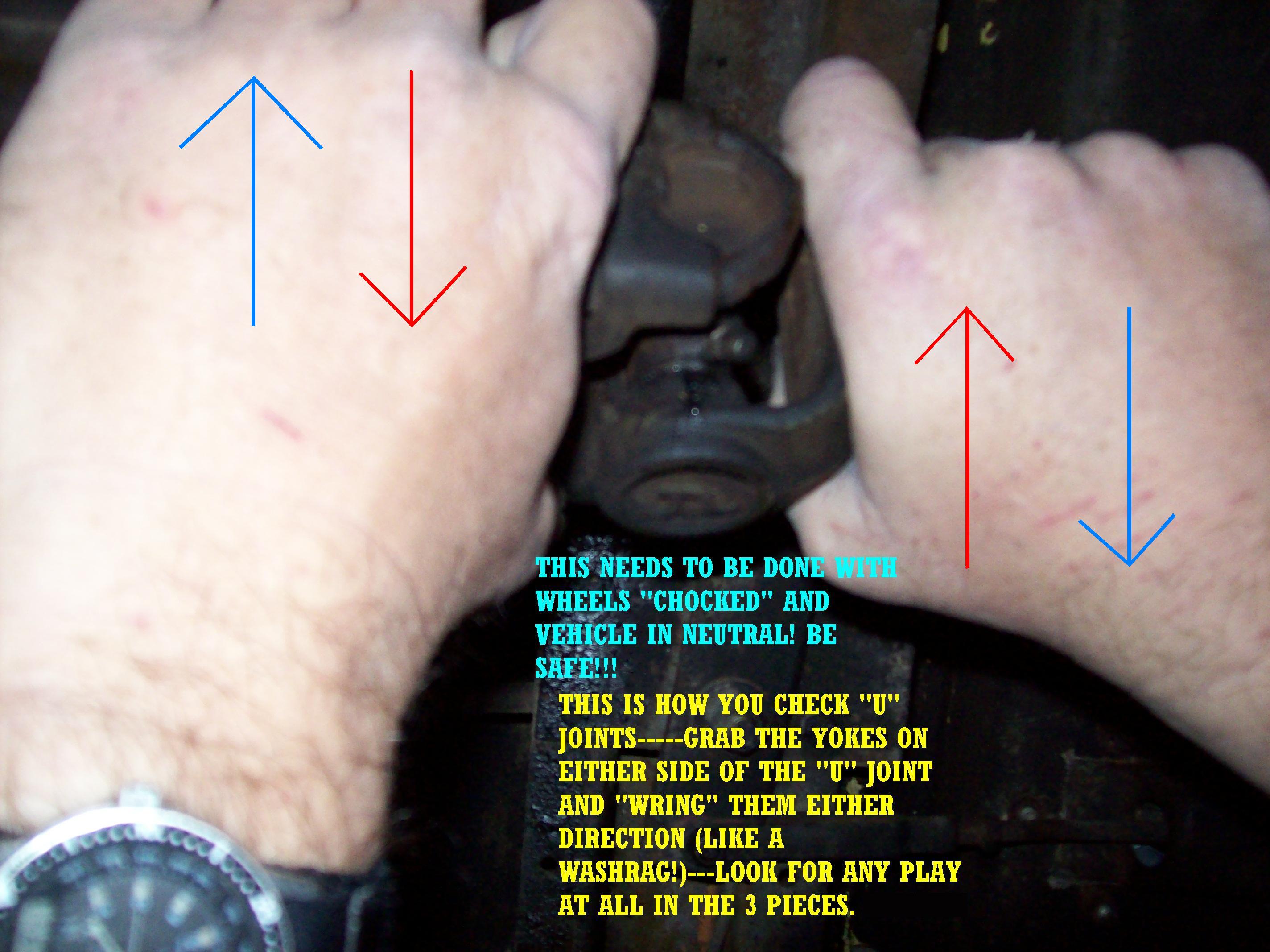

check all your ujoints in the driveshaft. if you see rust around the seals then they are bad.

I will take a look at those Ujoints today and replace as needed. I have check them before by putting the truck in forward and then reverse to hear for a clunk sound, haven't notice that sound yet.
If the ujoints don't have ware on surface where the needle bearing ride should the ujoint be replaced? I have had ujoints that had ware pattern on the shaft under the cups and replace them, checked them a year or so later and had the same ware pattern (not on this truck). Should I pack the new ujoints with hi-pressure grease. Before I only used the regular grease to grease them if they had a fitting to grease with or didn't grease them because they come new with grease on the needle bearing. I have been told that is junk grease, is that true?

there shold be no marks indicatitng a wear pattern . using regular grease is fine as it is mostly good for ujoints,/wheel bearings etc. if you have a center support bearing check that as well. Of course this could be something else like engine or transmission as well. also one other thing. Spray water on your belt and see if anything is going on there. recommended replacement of belt &tensioner is 60k and you are nearing that. see pic for center support bearing.

I can't believe so little ware would cause that much vibration. Two ujoints showed sighs of ware on one post each while the third was in good shape but replaced it anyway. Those were the hardest ujoints I had ever replaced. Vibration mostly gone. The center support bearing had no slop in it so I didn't replace it. I had replaced the belt at 50k but have not replaced the tensioner. Tomorrow I get my transmission fluid thermostat bypass. Will be installing 2 more coolers because when my total weight is over 14K towing my travel trail in slow and steep long hills the tranny gets rather warm by the fluid temperature gauge I installed. It top out at 260 degrees on one hill. Out on the open road there is no problem of it getting hot right around 160 degrees or less with the torque converter locked, plenty of air flow through the stock tranny cooler. On hills at HWY speed with the torque converter unlocked the temp will move up to 200-220 degrees. This truck is equipped with a tow package but just doesn't have the cooling needed for the tranny. I now see how others burn up their transmission by pushing too hard. I have plenty of engine but the build up of heat in the transmission is a limiting factor of how much power to apply. I have been changing the fluid and filter every 25K and adjusting the bands. After installing the cools got to figure out what causing the truck to pull to the right while braking.
