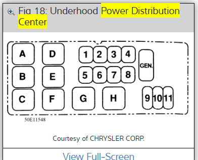

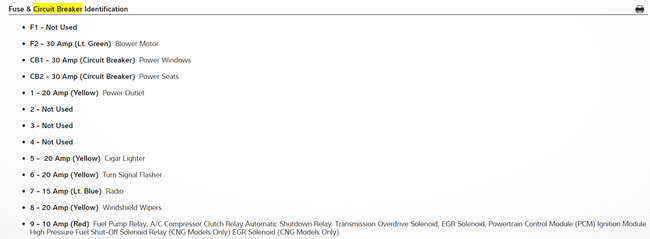

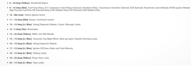

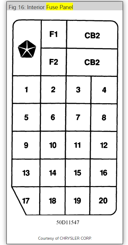

Started truck to warm up , shut off after about 5 min. Would not start back , no sound of fuel pump priming. could not find a fuel pump fuse, still no fuel pump priming. Checked for power to relay with key on and off checked out ok. Suspect bad fuel pump, replaced with new Bosch fuel pump. Still no fuel pump priming. Know suspect electrical problem but don't know where to look.
Dec 12, 2008 at 12:27 PM
  • 75,988 POSTS

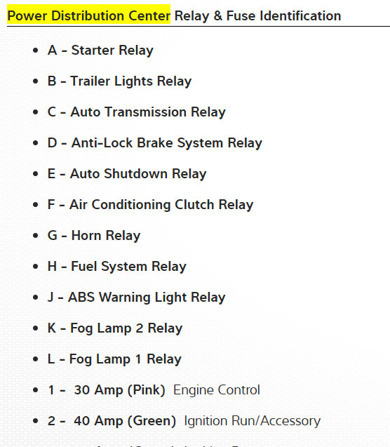

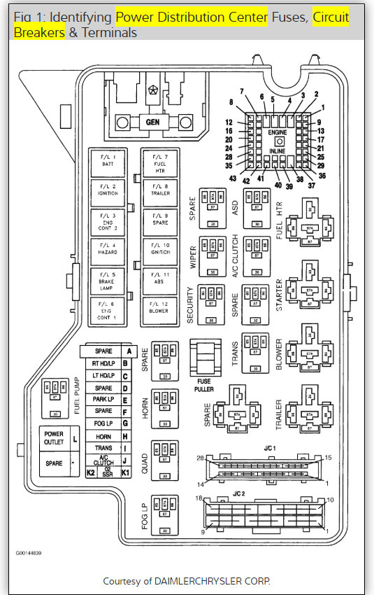

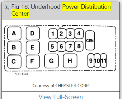

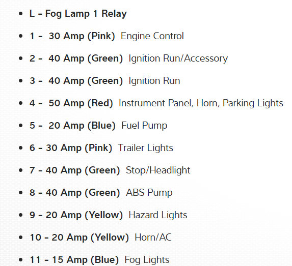

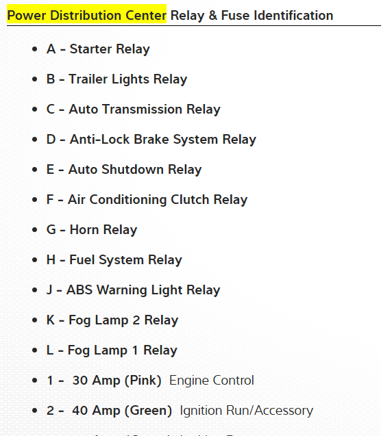

It sounds like the fuel pump relay is bad I would swap it out the location is in the diagrams below. Check out the diagrams (Below). Please run this test and get back to us.

Did you get that power from the dark green and black wire at the relay ? This wire powers the pump

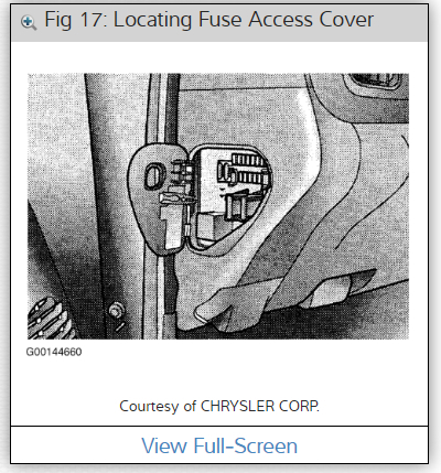

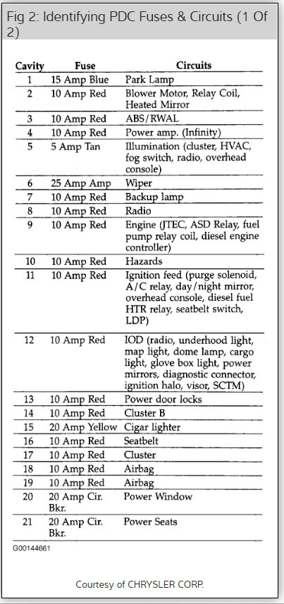

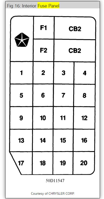

RACEFAN966
  • 5,029 POSTS
OK first off you need to check fuse number 9 in the fuse box inside the truck. Now if this is good then in the under hood fuse box there is a fuel pump relay and an auto shut down relay. I will need you to be able to check both. Now you will need to have a digital multi meter for this part. Let me know if you have one and I will walk you through the test to see what is or isn't going on. Thanks and get back to me.

98 Ram 1500. Battery went completly dead. Went to jump start with a plug in type charger. Used the start mode less than 3 minutes. Now fuel pump wont power up. Checked all fuses. Checked ground wires on batt terminals(replaced). Checked ASD and fuel pump relays. Relays checked good but no power to terminal 86 with ignition on. Where do I go next. The schamatics are hard to read. It looks like the power is comming from the ignition switch??
Aug 25, 2020 at 10:11 AM (Merged)
JDL
  • 16,098 POSTS
I'm not sure of engine litre size? Fuse 9--10 amp fuse, use testlite, check fuse circuit for voltage, goes hot when you turn on the key. Also, check fuse 3-- 20 amp fuse in power distribution center under the hood, use testlite on fuse circuit, should be hot all the time. Let us know what you find.
WINCHESTER RAM
Like I said there is no power comming from the PCM to the #86 terminals on the ASD or the Fuel relays. Is this a ignition switch or PCM problem.
