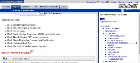

A while back me and my brother were driving the truck and for no apparent reason the truck shut off we tried to start it back up and leave but to no success. We had to have it towed to the house and after the tow truck left, I for the heck of it tried to start it and wouldn't you know it, it started so far I have replaced the idle control valve, the ignition coil, done a tune up and just last week replaced the fuel pump and with an oem pump and after all that it still shut off. Any ideas? This is driving me insane and i'm about to have it towed to the dealer as a last resort. One more thing we have owned the truck since new and we are the original owners.

Hi pontgt01, Welcome to 2carpros and TY for the donation
Starts up but shuts off-see below possible causes:
https://www.2carpros.com/forum/automotive_pictures/12900_start_bu_tstalls_2.jpg
