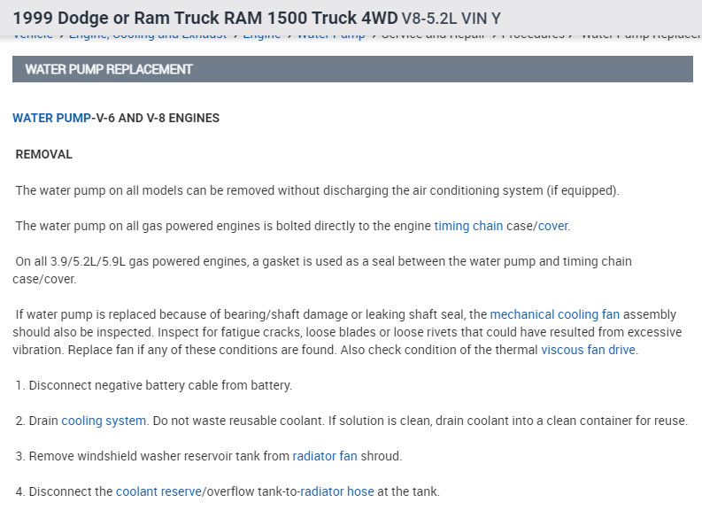

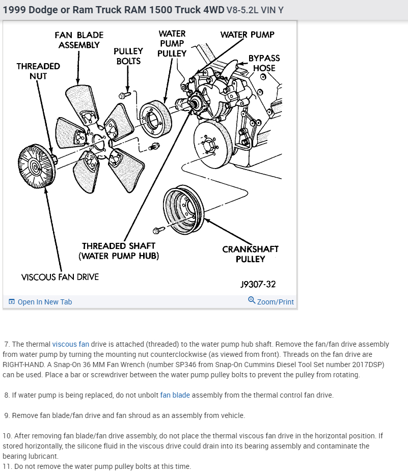

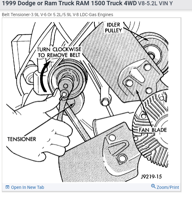

How do i get the fan off my truck so i can replace the water pump?
100,000 MILES • V8 • 4WD • AUTOMATIC
RHURLESS

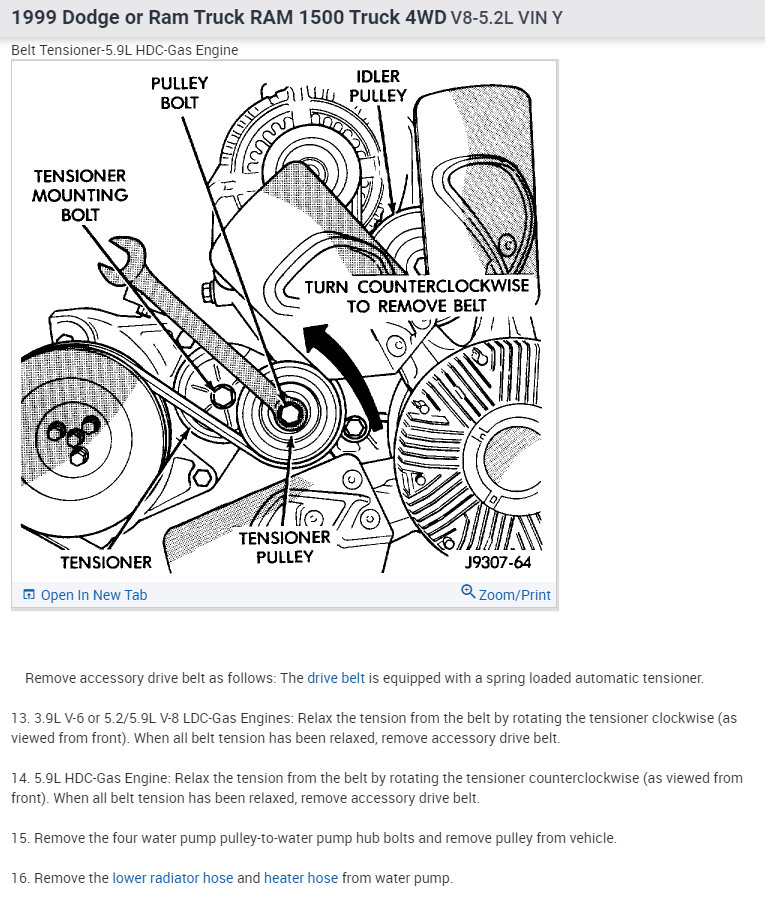

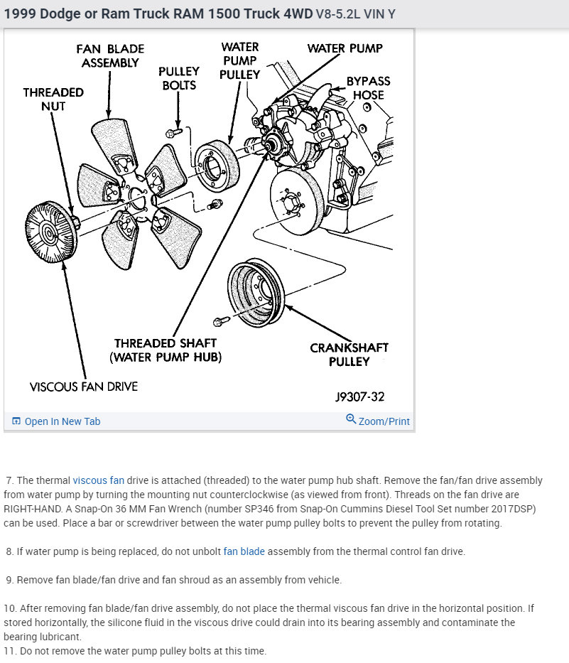

clutch fan removal so I can change out the water pump.
Aug 31, 2009 at 4:47 AM
OBXAUTOMEDIC
  • 3,711 POSTS

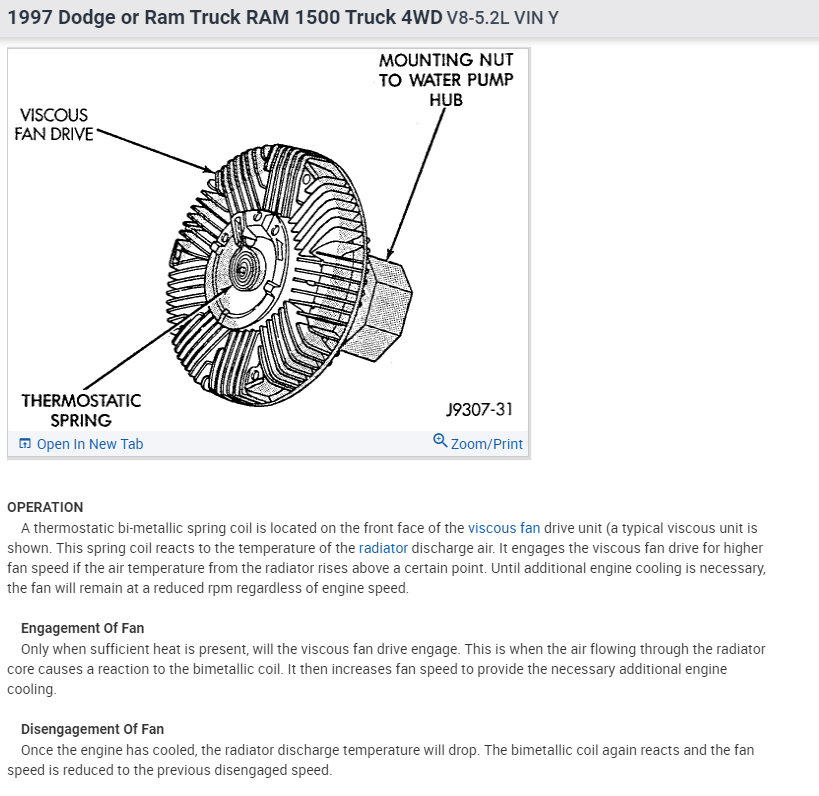

Check your local rental store and see if they have the tool below, will make it a whole lot easier....
https://images.2carpros.com/forum/automotive_pictures/188069_24947_14.jpg
May 13, 2021 at 5:21 AM
SQM
  • 6,383 POSTS

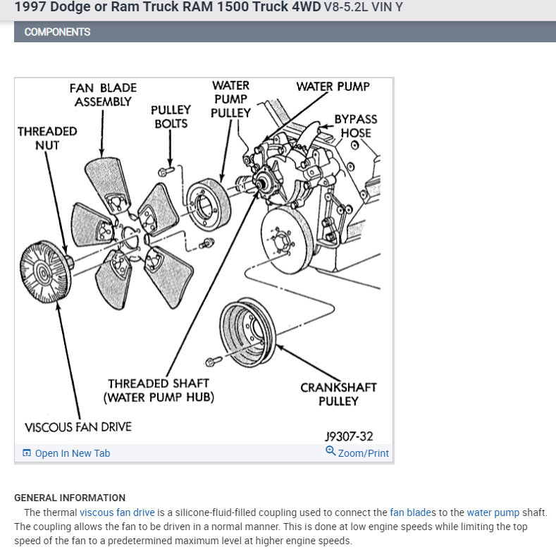

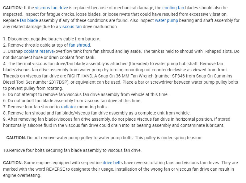

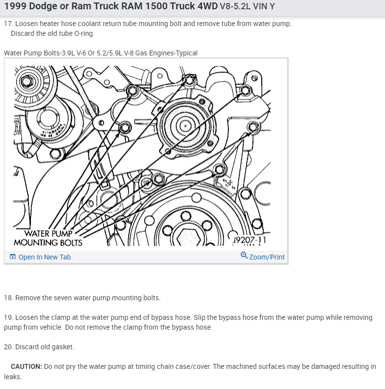

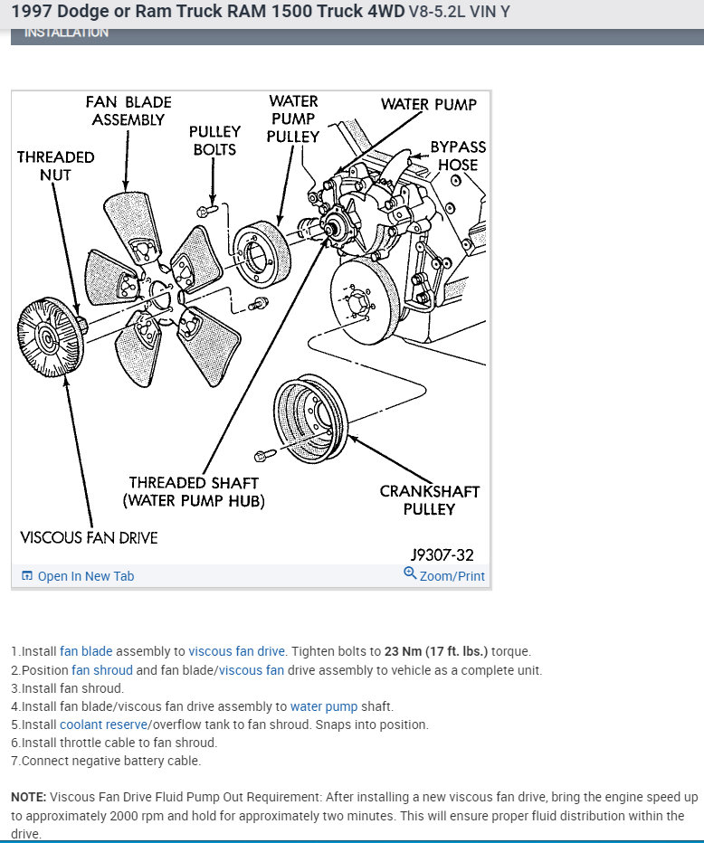

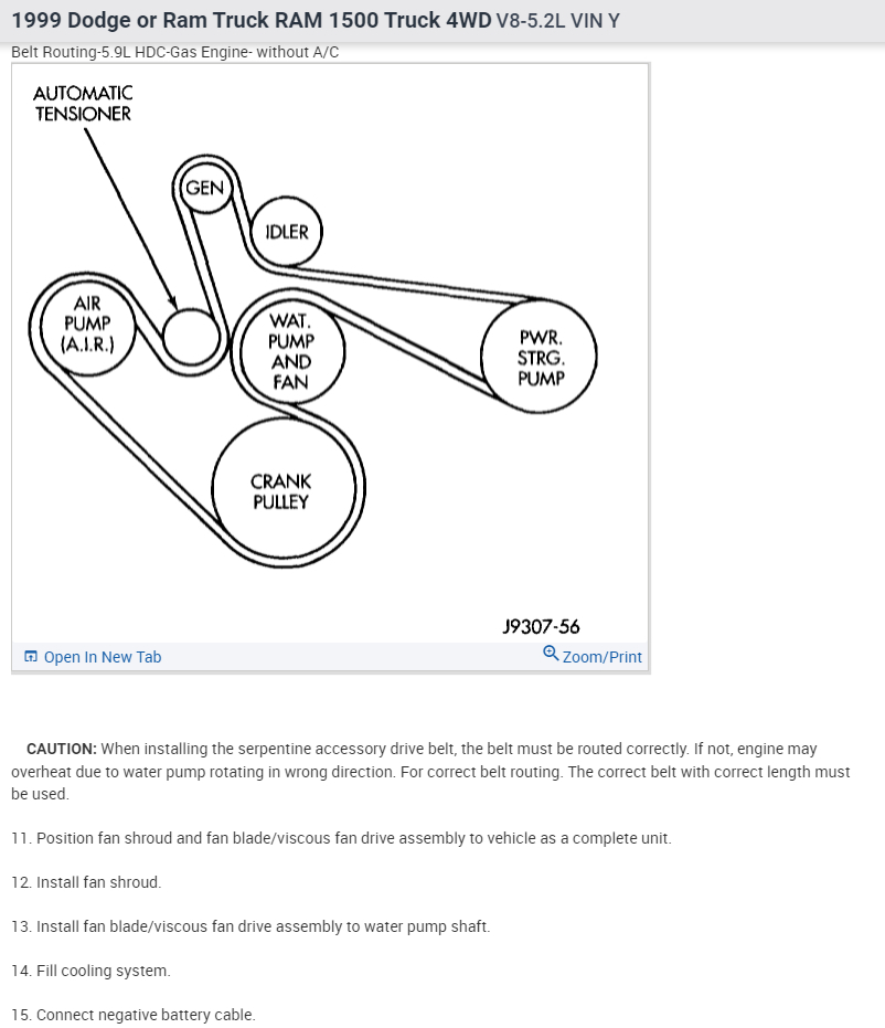

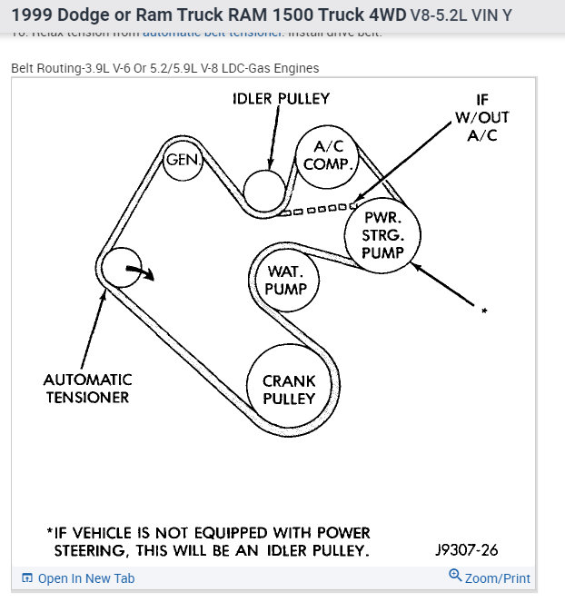

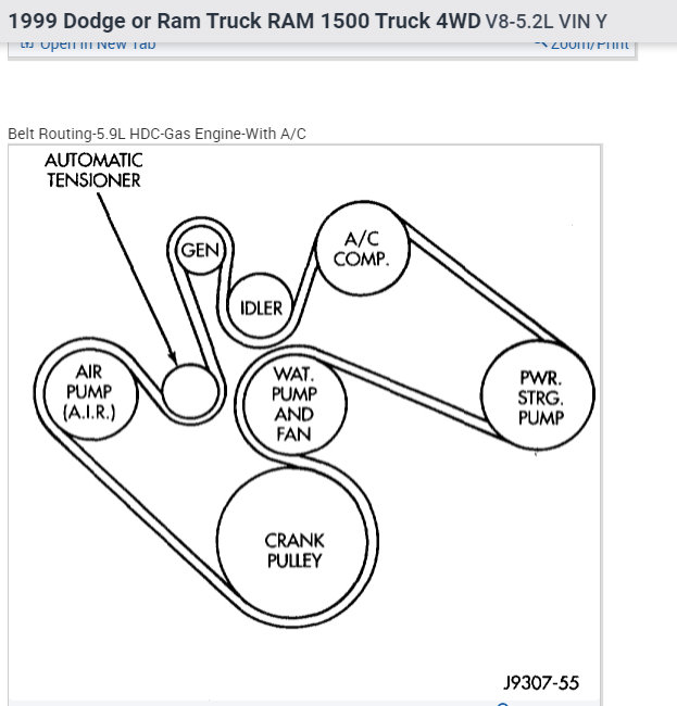

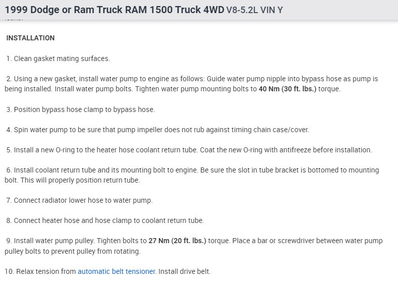

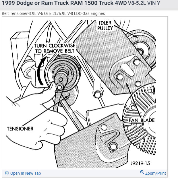

In order to remove the fan clutch, you will need to use a fan removal tool. Those tools can be borrowed from your local auto parts store.
Here is a helpful guide:
https://www.2carpros.com/articles/fan-clutch-removal

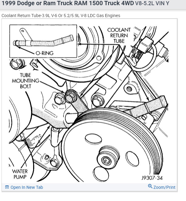

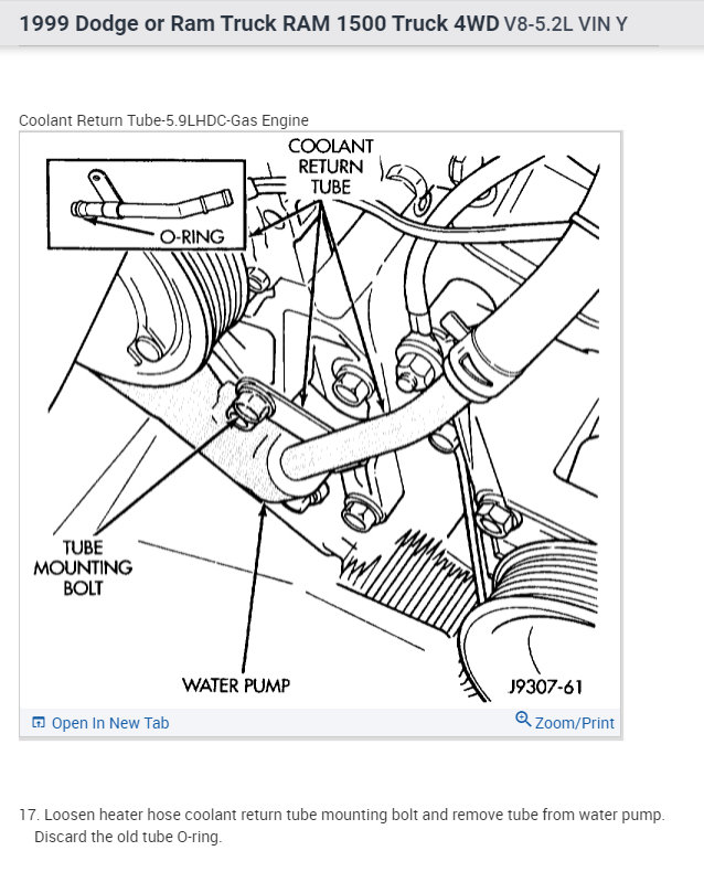

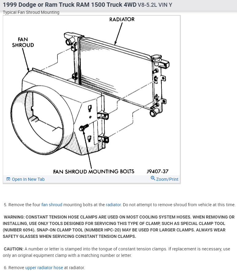

I have attached the fan clutch removal and installation procedures as well as the water pump replacement instructions below.
