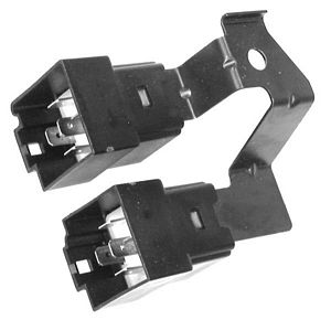

HAVEING TROUBLE STARTING ENGINE...IF YOU SIT WITH THE KEY IN THE ON POSITION AND WAIT FOR AWHILE YOU HEAR A RELAY CLICKING ONCE THE RELAY STOPS CLICKING THE ENGINE WILL START...REPLACED THE RELAY PART# RY607-STANDARD ING. -OR- BORG WARNER#R3224...STILL HAVING THE SAME PROBLEM...WASTE OF MONEY...PLEASE HELP WITH THIS PROBLEM IN NEED BAD..AND MONEY IS LIMITED..-JOHN[img:d0b2e8e052]http://www.2carpros.com/forum/automotive_pictures/115052_RY607_1.jpg[/img:d0b2e8e052]

Relays need a certain amount of voltage to operate correctly.Sounds like there might be a low voltage or bad ground causing the relay to click until it finally gets a good connection.Unplug the relays and check power and ground with a meter. Get back to me

Unplug the relay and check power and ground with a meter. Low voltage or a bad ground can make the relay click until it finally gets a solid connection.
