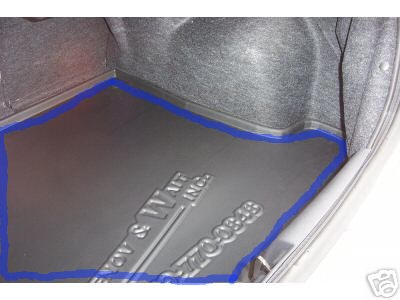

Is it the area in blue that you need to do?
https://images.2carpros.com/forum/automotive_pictures/30961_neon1_1.jpg
Feb 16, 2007 at 10:06 AM
TWIZTIDMAFIA
  • 43 POSTS
not quite to a "T" and not to mention the other half of the trunk, LOL...but yes, i dont want any on the sides just the matt wall to wall custom fit around all the edges

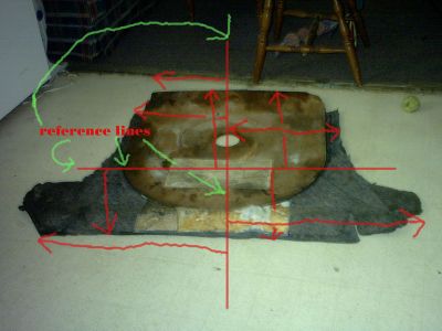

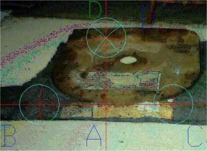

Okay with the file type. Do you see how we need to measure?
https://images.2carpros.com/forum/automotive_pictures/30961_templatewithcenterwm4_copy_1.jpg
The reference lines need to be perfectly square to each other.
https://images.2carpros.com/forum/automotive_pictures/30961_winksmily_2.jpg
Feb 16, 2007 at 1:03 PM
TWIZTIDMAFIA
  • 43 POSTS
ok so 4 quardons.....each one measure up and down left and right.....and then after i get the measurements what how to relay them to you....like -y1r ( meaning like first mark on the bottom middle line going to the right is x amount of inches long, so id send you a formula like this
-y1-r=15 inches
-y2-r=15.25 inches etc..etc???
basicaly the easiest way to make the center dot would be to measure how deep i want it ( Y Axis ) to go, say 35 inches and then shoot the X Axis lines off that lines middle mark ( 17.5 " ) span across get the center mark of the x axis line and then adjust my Y axis line accordingly to the center of the X Axis right?
EDIT: how do i measure a straight line through a wall ( IE the curve at the back of my trunk, ill be able to get the left and right x axis width measurements, but how to i get the up and down y axis measurements, less you want me to treat the corners as its own plane and make a new place map without lossing or gaining any extra inches while creating a new plane like measure as far as i can go up and down, and then make a new XY map for the corners??? i dunno sorry if im confusing you i got like 100000000 ideas goin through my head i wanna go start now LOL

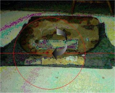

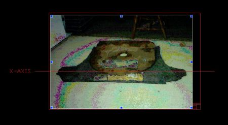

Take you time on this the layout is absolutley critical. IF that isn't right the project is scrap. Points to keep in mind: What ever you use for a straightedge on the x-axis has to be perfectly straight. You should get a metal 3" yardstick or similiar. wood will not work right as it is not perfect. If your laying this out right on the trunk bottom and it isn't flat the measurements will vary. Best bet is get somthing flat and rough cut it to fit and secure it in place, 3/4" particle board? The x and y axis have to be perfect 90 degree angles.
https://images.2carpros.com/forum/automotive_pictures/30961_xaxis_1.jpg
I would locate the x axis at the longest distance.
https://images.2carpros.com/forum/automotive_pictures/30961_loccenta_1.jpg

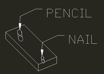

You can make a home made compass with a stick, nail and pencil: To scribe points for B & C.
https://images.2carpros.com/forum/automotive_pictures/30961_COMPASSbw_1.jpg

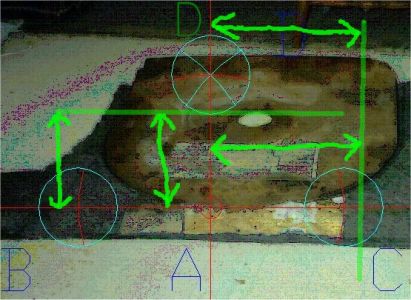

https://images.2carpros.com/forum/automotive_pictures/30961_squarea_3.jpg
After you pick your origin (A), you need to scribe points at B & C. Then lengthen your “compass” to scribe marks for point D, by placing the nail at points B & C on your x-axis. Make you y-axis by drawing a line that intersects points A & D using a perfect straight edge like used on the x-axis You may want to make a few parallel lines to the axis's and increment them also. That way you are staying straight for your measuements.
https://images.2carpros.com/forum/automotive_pictures/30961_paralell_1.jpg
The origin (Point A) will be (0,0).
