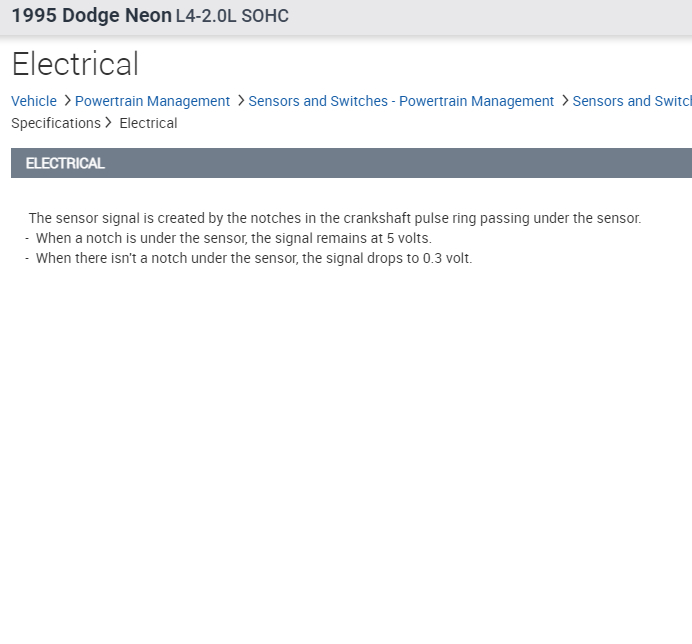

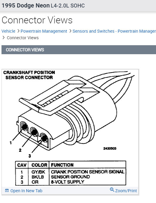

The problem ended up being the crank trigger. After the ECM was replaced the same symptoms happened, but the crank trigger solved it. The thing is that it was a new trigger only a 1.5 years old. 15 minutes and stalling, like clockwork. $230.00 at the dealership yeah!
Friday, April 16th, 2021 AT 1:28 PM
SQM
  • 6,383 POSTS
Appreciate you updating the fix for the issue.

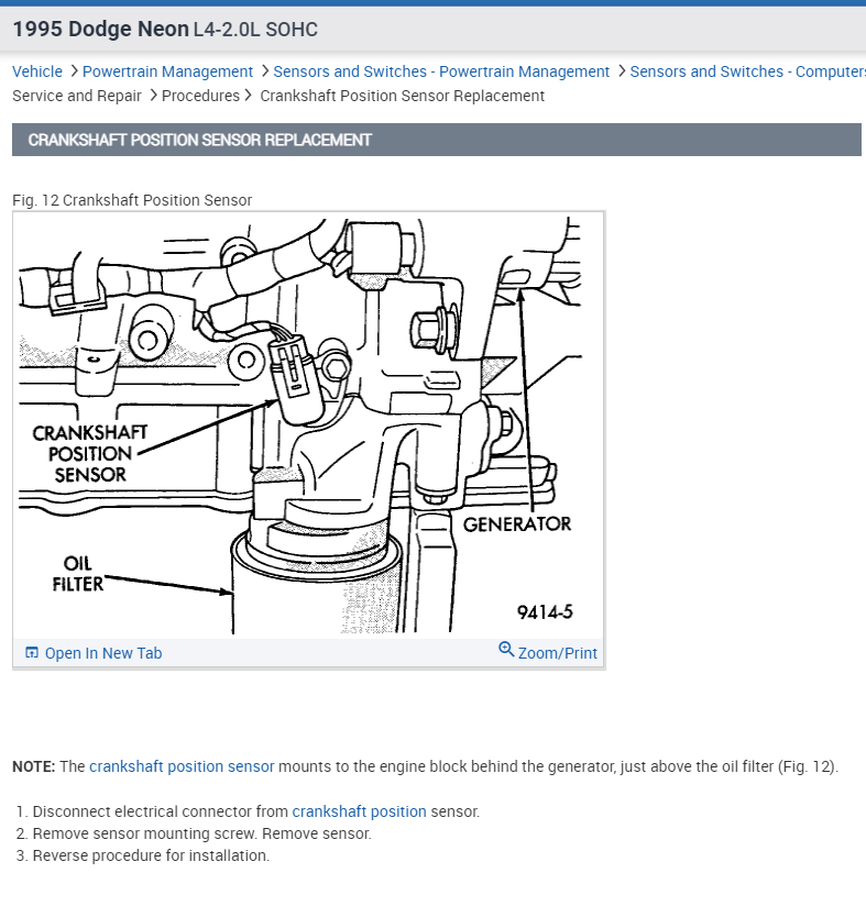

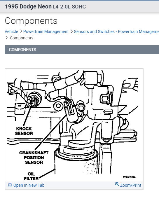

The crank position sensor is located on the lower part of the engine. Next to the oil filter housing.
I have attached diagrams for anyone else might be looking to replace that part.
