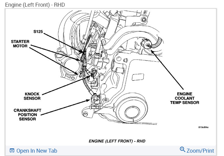

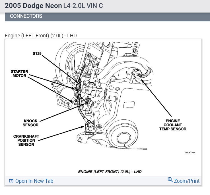

car is hard starting after sitting all night in a garage or after sitting all day outside at work. new plugs, air filter, oil changed, PCV valve changed. could it be fuel pump or coil pack. car runs fine after you get it started and it runs for a few to smooth out.Limited funds to fix. can't afford to just start replacing and cant afford to take to dealer.
Nov 25, 2009 at 11:44 PM
LEGITIMATE007
  • 5,121 POSTS
It sounds like you have an engine coolant sensor that is not working right here are two guides to help us see whats going on and the location of the sensor so you can change it out.
https://www.2carpros.com/articles/coolant-temperature-sensor-cts-replacement
and
https://www.2carpros.com/articles/engine-cranks-excessively-before-starting
Check out the diagrams (Below). Please let us know what you find. We are interested to see what it is.
