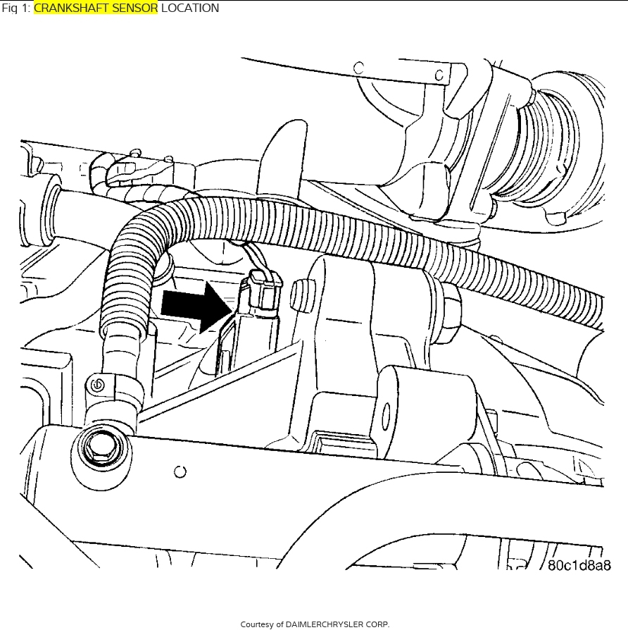

Engine died after short trip to work. I checked and there was no fire on #1 and 4 plugs. I replaced coil pack , computer code reader showed Po340 cam sensor malfunction. Replaced cam sensor, car will not start. Engine will turn over, checked fuel rail is getting gas , replaced on board computer 2 years ago 2 fuel injectors were on all the time. Is there anyway to check on board computer to see if it is working properly. Computer code reader is showing NO CODES!!!

Are the injectors pulsing? It sounds like it could be the crankshaft angle sensor, its a common problem,

Hi Richard,
The cam sensor will not keep the engine from starting, their will be no codes set for a failed crankshaft sensor which will keep the engine from starting,
No codes are set for this sensor because the computer thinks the engine is simply not turning, ie. stalled, out of gas etc.
You can sometimes use a voltmeter set on mila-volts to see if voltage is generated when the engine is being cranked over, it should be a three wire connector, test all combinations.

Hi RJSteiger,
Sorry for the confusion, without the engine running the computer cannot gather current codes, if the engine has a broken timing belt/chain it will not start. Does the engine sound normal when cranking over?
It looks like the sensor is just above the starter in this diagram
Please let me know
Best, Ken
