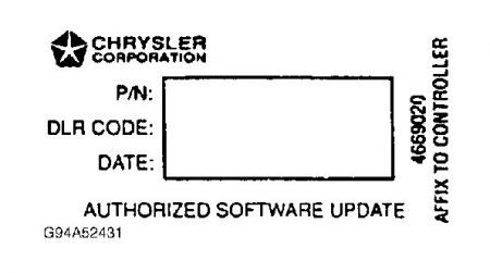

does it make a difference if it is cold (setting 8hrs) or after driving for 20 minutes or more? has the pcm software ever been updated? is there a label under the hood like this?
https://images.2carpros.com/forum/automotive_pictures/30961_label_1.jpg
Jan 14, 2007 at 7:22 AM
DAVID51572
  • 7 POSTS
i have to check. i will let u know..thanx
Jan 14, 2007 at 7:41 AM
SERVICE WRITER
  • 9,123 POSTS
At this point, that is where I would start, is update the software.
