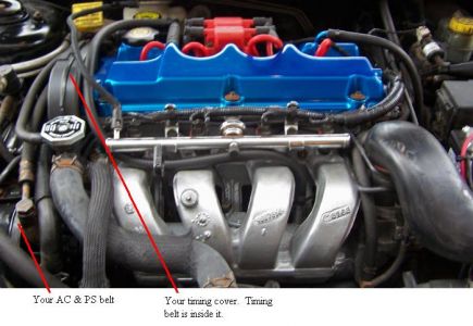

Let's tackle this as two separate problems. 1. 2 alternators and a battery in the past two months. Please explain a little bit more in details as to why you have to replace 2 alternators in the past two months. 2. Timing belt issue. You said that a friend had looked at the vehicle and told you that the timing belt is still there. Where did he or she look? Is he looking at here?
https://images.2carpros.com/forum/automotive_pictures/55316_98neonbelt_1.jpg
Your timing belt is located inside the timing cover. Everything in front of the timing cover will have to be removed in order to access it.

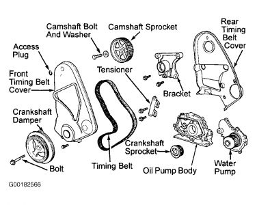

https://images.2carpros.com/forum/automotive_pictures/55316_98neontiming_1.jpg

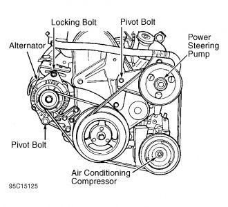

With your mileage, if the timing belt has never been replaced, there is a chance that it broke. I have seen many Neon/Stratus/Breeze that the timing belt has snapped at around 120K - 125K miles. Sign of broken timing belt? Other than actually opening the timing cover, you can only crank but will not start. What I would do if I were you is to go back to the garage and have them show you exactly what they mean by the timing belt. Play "dumb". You have the pictures of how it is supposed to look like behind the timing cover.
