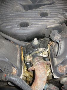

SDINEEN
  • 23 POSTS
I didn't notice this was leaking until I caught it in action. Pic attached. Can anyone help me with what exactly this is? Looks at first blush like it might be somewhat easy to replace, feedng back in to the engine block from the radiator, with a little vent on top. Is there a quick fix/gasket?
