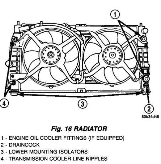

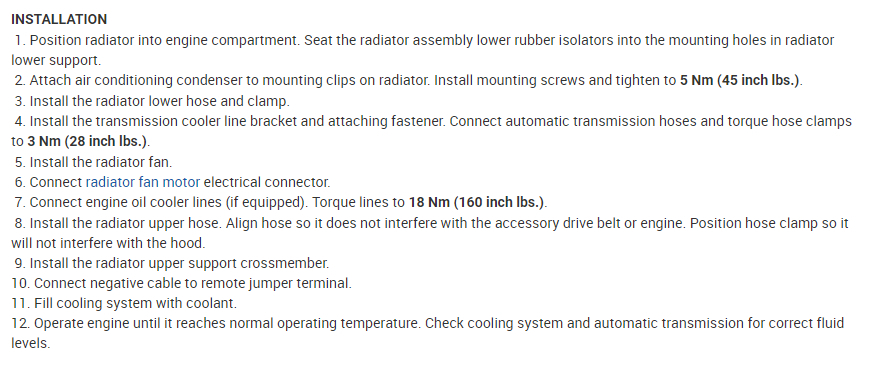

There is coolant leaking from a small piece on the top of the radiator. The car is not overheating but it does take a while to pick up when I press on the gas. What is this problem and will it be expensive to fix?

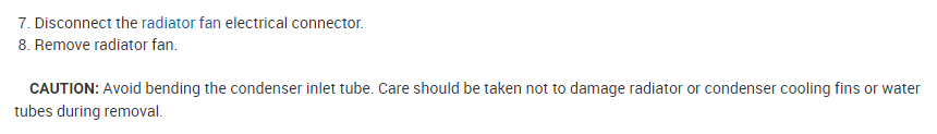

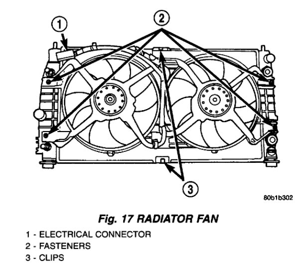

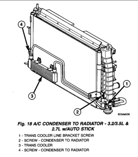

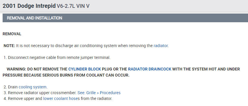

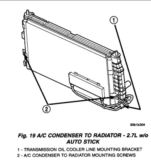

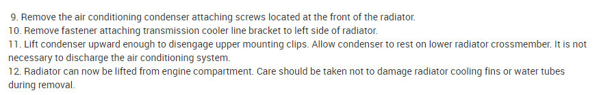

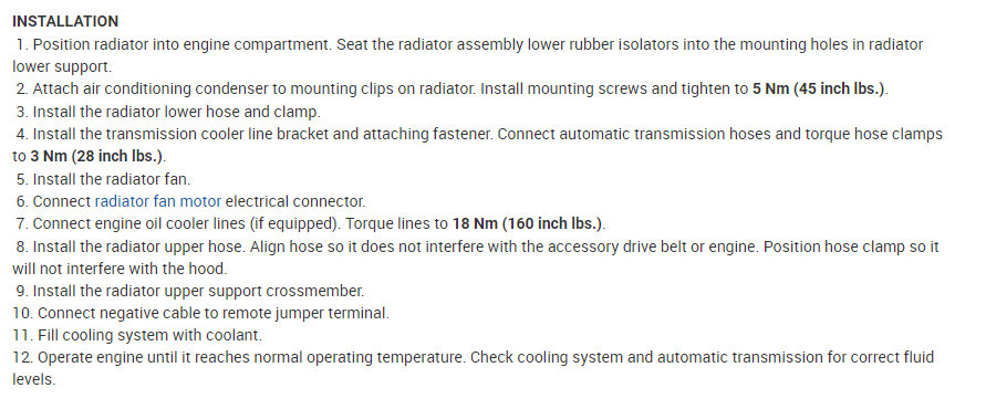

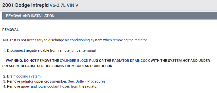

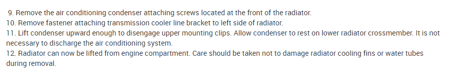

Here is the information you requested. Here are a few tutorials for you to view on how to replace a radiator and drain and fill the engine coolant:
https://www.2carpros.com/articles/coolant-flush-and-refill-all-cars
https://www.2carpros.com/articles/how-to-replace-a-car-radiator
I've attached picture steps below on how to replace the radiator on your Dodge. Hope this helps and thanks for using 2CarPros.
