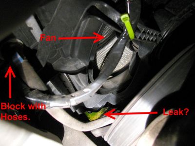

Had to put more coolant in today, it wasn't as dramatic as a few days ago, there was an inch or so in the tank at the end of the day and this was driving about 90 miles today. Also I took a flashlight and was looking around as best I could and noticed where there might be a leak at. There seems to be coolant puddled up a bit under the radiator fan on the right side. I took a picture, I hope it helps.. So maybe it's just a hose or the radiator leaking or something. Thanks for the input so far y'all!

Usually, if those radiators leak, it's where the core meets the tank. Right where your arrow is. The new radiators are all aluminum and plastic and just don't hold as well as the old copper ones. Plus, they are considered non-repairable.

[quote:dca4585074="James R. Weizel"]Usually, if those radiators leak, it's where the core meets the tank. Right where your arrow is. The new radiators are all aluminum and plastic and just don't hold as well as the old copper ones. Plus, they are considered non-repairable.[/quote:dca4585074]
So they would just have to replace the whole radiator then right? That's a better scenario than a head gasket being blown I'd imagine? Thanks again for the help. Also, why do you think there isn't any overheating issues?? The car runs at normal temp all the time.. I would think losing coolant would cause the car to run hot or something. Do you think it would be worth trying a few bottles of coolant leak stopper?? or does that stuff tend not to do anything?

It probabaly didn't overheat 'cause you caught it soon enough. As far as a "stop leak additive" you have to keep in mind, it is just a temporary fix. It will come back to haunt you. If you decide to go with a new radiator, this is one area where it really pays to shop around. I bought most of may customer's radiators from a local salvage yard, brand new in the box and about 30% cheaper than a parts store. Hope this helps.
