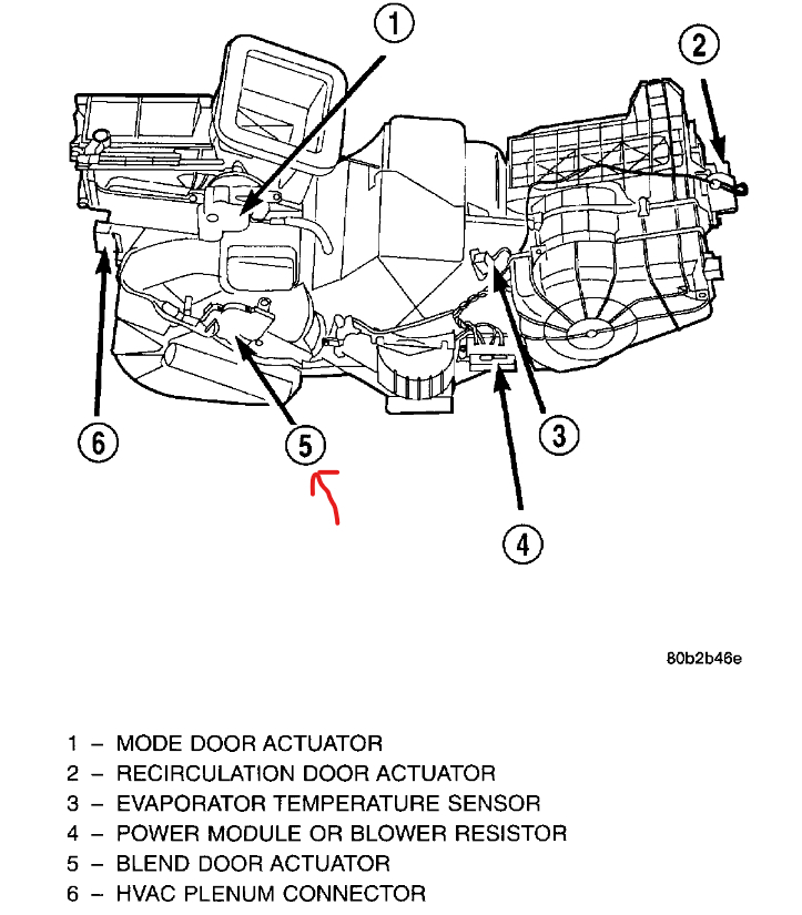

no heat coming out from inside the car?
PAMOCO
Heater problem
2001 Dodge Intrepid V6 Wheel Drive Type unknown Automatic 100000 miles
is no heat coming out from inside the car and i dont know wich antifreeze put

are you saying there is no heat coming out of the vents as in the blower works but no heat comes out or the blower doesnt even work.
and what were you asking about the antifreeze?

I would first check the coolant level because if it is low the heater will be the first thing that stops working.
https://youtu.be/GSE9skKnOgY?si=Y6pZXr771IDTM3ul

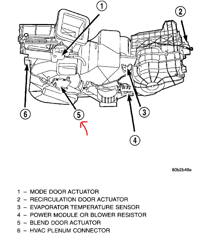

If the coolant level is okay I would swap out the temperature blend door actuator, but first go over this guide which may help as well.
Here is the location of the temperature blend door actuator so you can fix the heater. it is #5 on the diagram. Check out the images (below). Let us know what you find.
