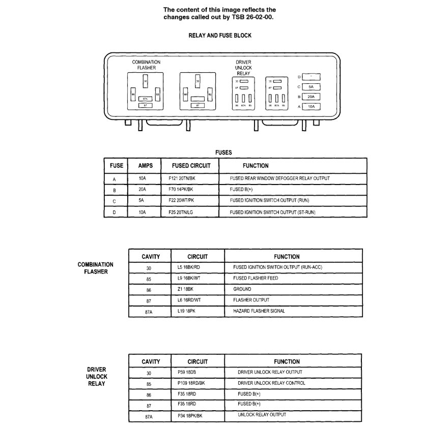

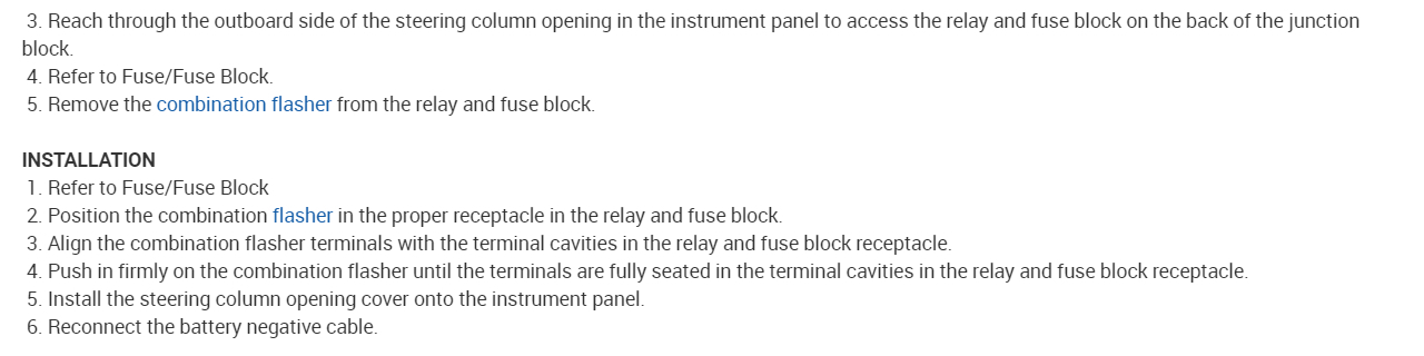

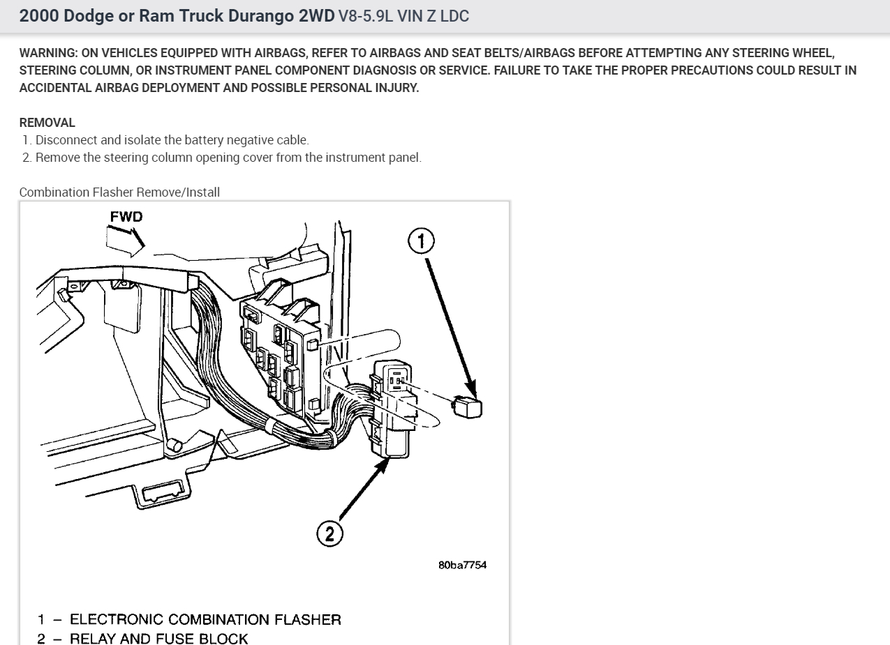

1999 dodge durango turn signal flasher location - The turn signal flasher needs to be replaced, but I can't find it. I've looked under the hood with the rest of the relays and fuses and also on the driver's side fuse block on the side of the dash. Can you tell me where it is on this truck?
Sep 29, 2007 at 4:24 AM
  • 55,676 POSTS
The turn signal flasher is located on the drivers side near the side kick panel. (diagram below) Please let us know if you need anything else to get the problem fixed.
