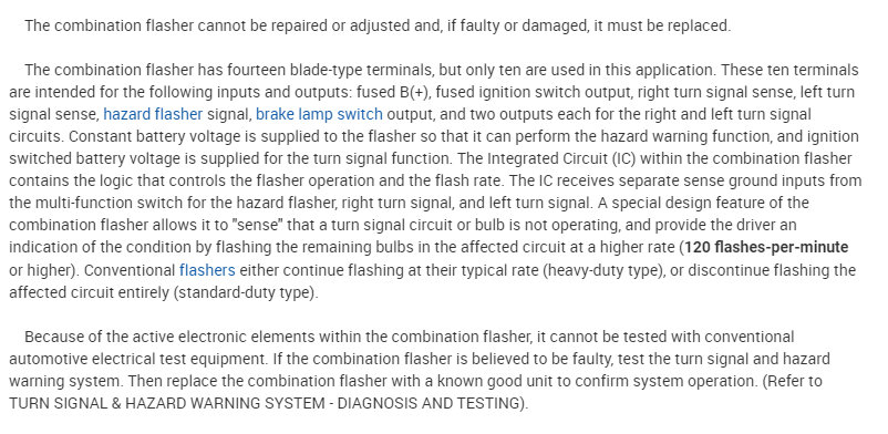

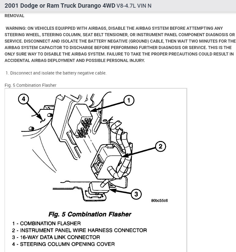

How do I replace my turn signal flasher
Sep 28, 2010 at 3:44 PM
SQM
  • 6,383 POSTS

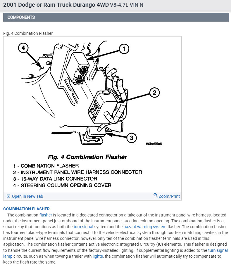

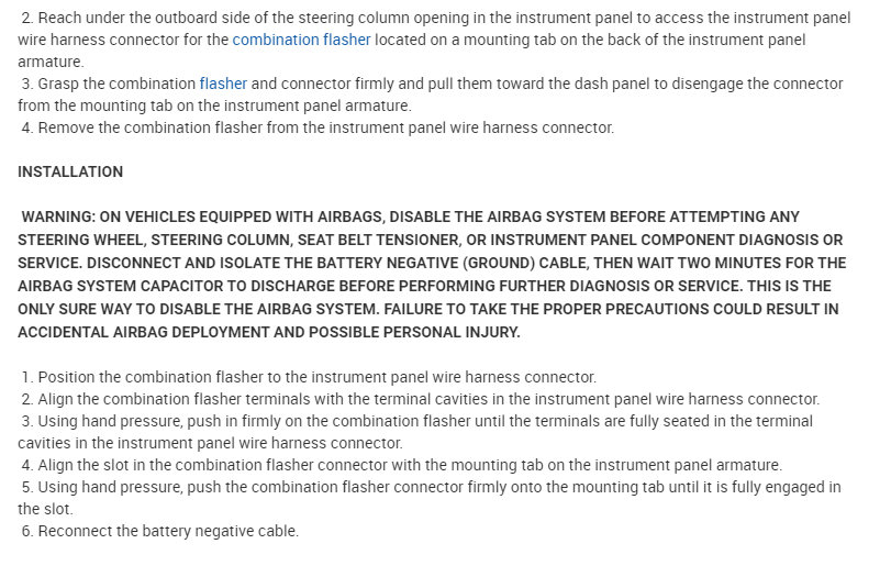

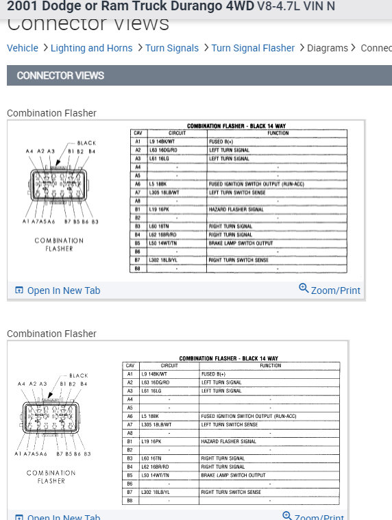

The combination flasher (turn signal flasher) is located under the instrument panel, outboard of the steering column opening. It is on the instrument panel wire harness.
https://www.2carpros.com/articles/turn-signals-not-working-blinker
I have attached the replacement diagrams for your reference.
