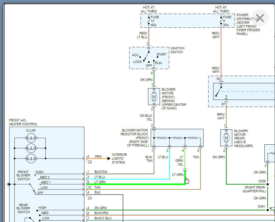

front blower quit ? I have checked both fuses for the air conditioner and they are both good ?

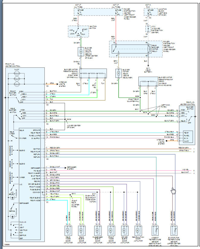

We need to check power at the blower. If you have power, then I suspect the motor is the issue. Jump 12 volts to the motor and see if it comes on.
If it does then we need to check the resistor shown in the wiring diagram.
