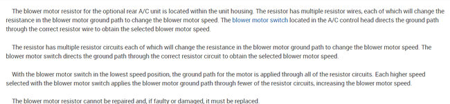

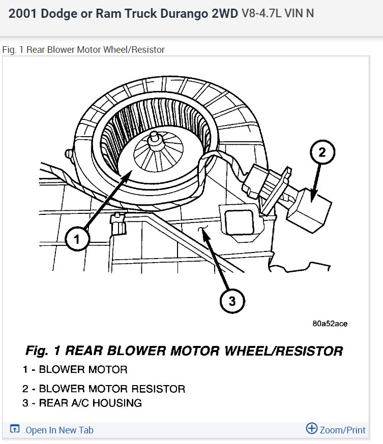

i have dual controls for the front and rear fan, a/c. the rear control works fine. the front control will only work on high. is there an inline fuse? i have checked all the other fuses and they are ok or do i need to replace the control?

You need to replace the blower resistor located under the passenger side of the dash (glovebox). I had the same problem and this fixed it.

Yep , i agree here is the location of the blower motor resistor so you can change it out. Check out the images (below). Please let us know what happens.
