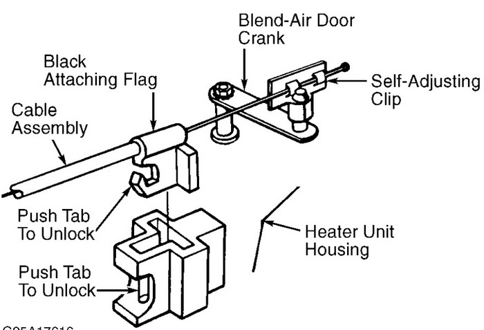

check to see if your actuators on your heater are working correctly. one controls air temp and another movement.pic enclosed of blend door

You may not have a water valve, but if you do, it's inline with one of the heater hoses. Years ago they had a cable running to them from the controls on the dash. Today they're run by a vacuum motor and will have a small vacuum hose going to it.
If the heater hoses are just as hot as the radiator hose, coolant is circulating through the heater core, and the temperature door in the heater box is suspect. Look for a cable from the temperature lever that is slipping on the door's lever, or a vacuum hose that is disconnected or leaking.
The temperature door can be rusted in the "cold" position too. That's when a cable-operated lever seems to work, but actually where that cable connects to the door's lever is supposed to slide somewhat freely. That is the self-adjusting feature, but when the door is stuck, the cable slides back and forth in the adjustment without moving the door. This problem usually shows up in winter after the door has been in the "cold" position all summer and had a chance for the metal hinge pin to rust.

With the engine at full operating temp, locate the 2 heater hoses where they go into the firewall and feel them to see if they are both hot to the touch. If not too hot to hold, then you have to look at the actual engine temp and if that is up, if it is, then your looking at a restricted heater core.
If you find that they are both too hot to hold, then the heat in that vehicle is controlled by a blend door that regulates heated air flow. it is operated by an electric motor/actuator. The problem can be that the actuator is stripped or inoperative or the door itself could be damaged. This is what needs to be determined by examining the actuator and see if it is responding to heat change commands or not.
If they are both not too hot to hold on to, then you either have a restricted heater core or the system is not completely full and getting air pockets for some reason.

It could be a couple things. First, with the engine at normal operating temp and the heater on high, feel both heater core hoses. Both should be hot. If only one is hot and the other slightly warm, flush the heater core. If both are hot, check the blend air door actuator for operation.

check for a broken temp control cable it can be broken at either end and not opening door so heat will work. also the heater may have a vacuum motor to open door so check for vacuum at door as well as a vacuum leak . we have no pics of this sorry
