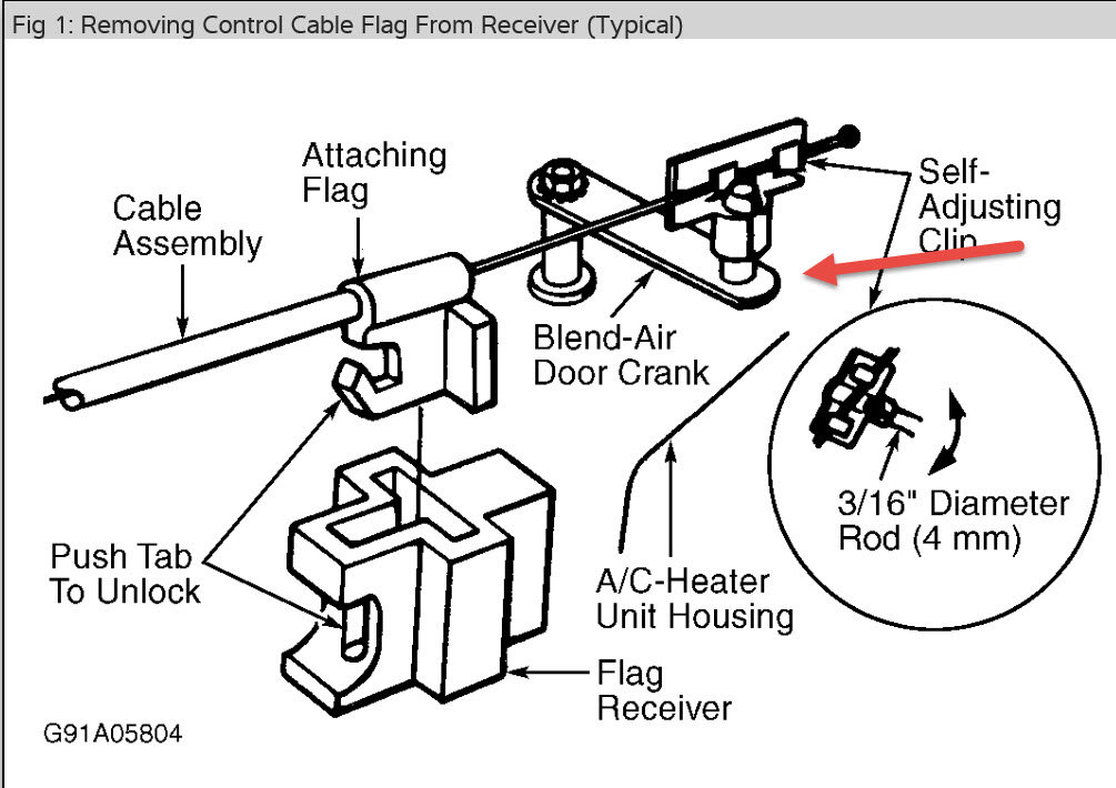

Why when I turn my ac on does the rear ac work perfectly,but my front vents blow out Luke warm air? What could be the problem or problems? Thank you very much

check to see if your cable for temp is broken and not opening door see pic
