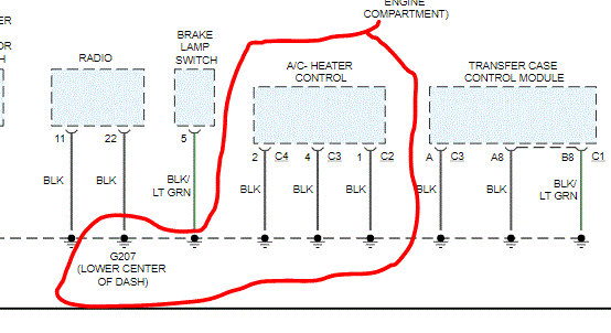

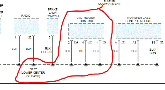

  • 110,244 POSTS
Is the motor going bad or the resister? I've seen motors that draw too much power burn up resisters, but you have replaced everything. The only other thing I can think of is if there is a weak ground. The ground is provided through the switch. Have you checked the switch?
I attached a pic of the ground. Check to make sure it is in good condition. A weak ground can cause excessive heat in the unit.
Let me know what you find
Aug 6, 2020 at 3:56 AM (Merged)

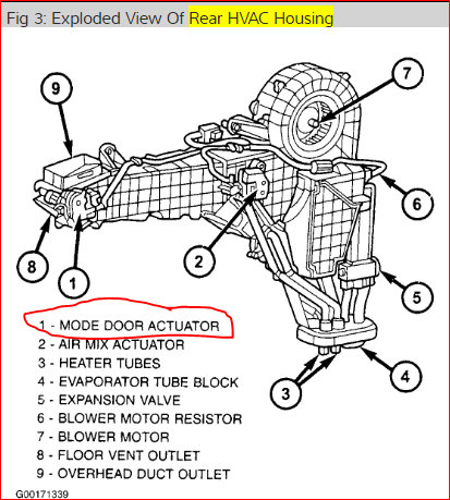

MARCALB
Hi, my heater gets the cat hot but when you put your hand to the vents it seems like it's not blowing that much. Also, the rear A/C control only blow cold it does not get hot. What is the problem?
DANNY L
  • 5,648 POSTS
Hello, I'm Danny.
On the front vents have you checked to see if all the fan speeds work? As far as the rear heater it sounds like you are having a problem with the mode/blend door actuator. Here are two tutorials for you to view for blower motor and blend door actuators to show you what is involved:
https://www.2carpros.com/articles/blower-fan-motor-works-on-high-speed-only
Below I've attached a picture of the rear HVAC system and circled in red the actuators location.It's basically an electric motor that controls which ducts the hot or cold air travels.Hope this helps and feel free to ask any questions if needed.Thanks for using 2CarPros.
Danny-
