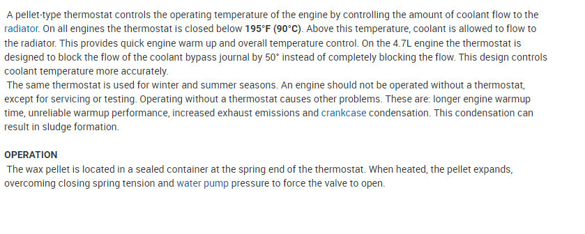

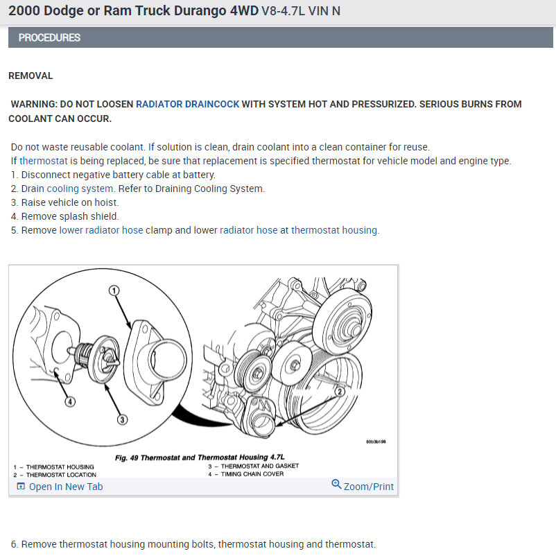

changed the thermostat and now it overheats what do i do?
Apr 21, 2010 at 12:40 AM
SQM
  • 6,383 POSTS

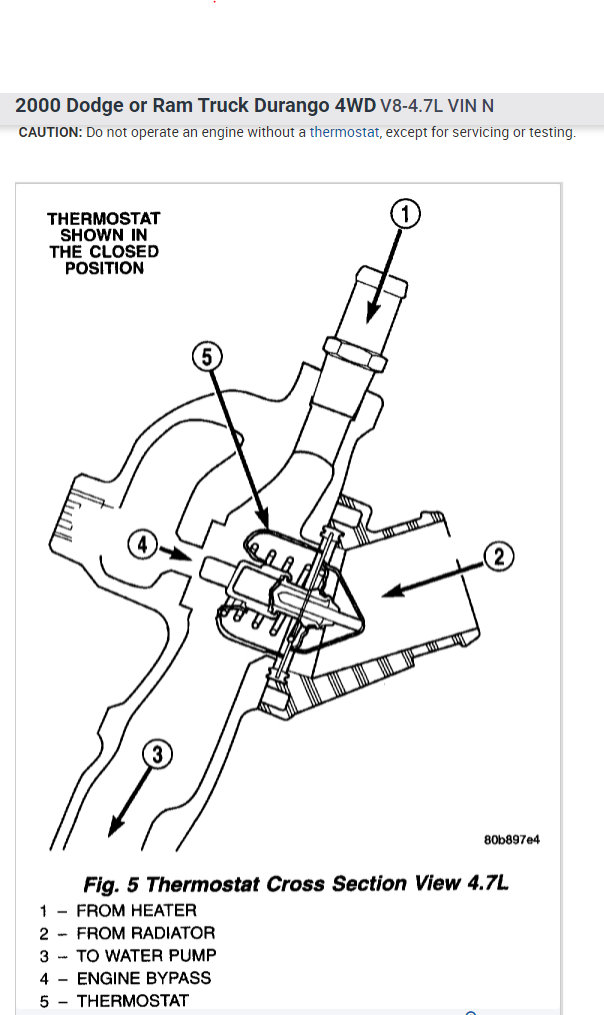

Did the vehicle had overheating issue before you changed the thermostat?
If it did not have that issue and just started to overheat after the thermostat replacement, it is likely that the thermostat is defective and need to be replaced.
https://www.2carpros.com/articles/how-an-engine-thermostat-works
https://youtu.be/EZ4luHCzBeo
The thermostat should open at 195F for your vehicle.
