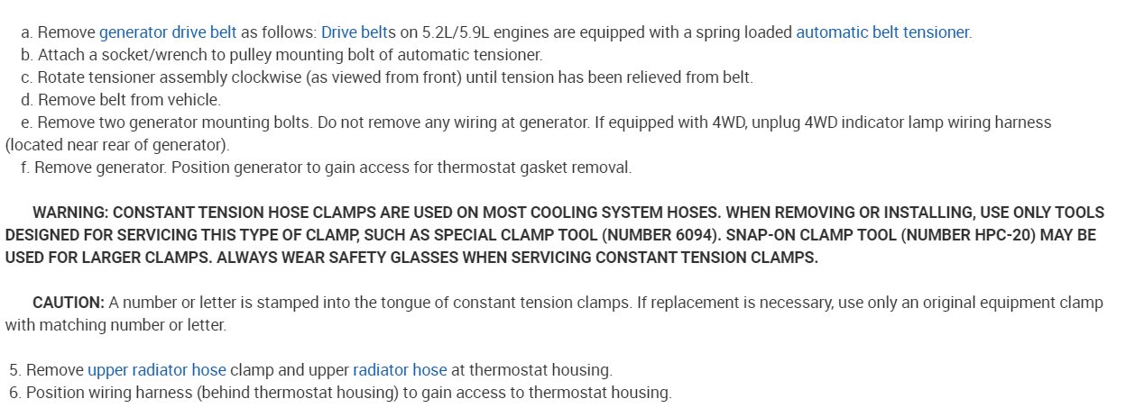

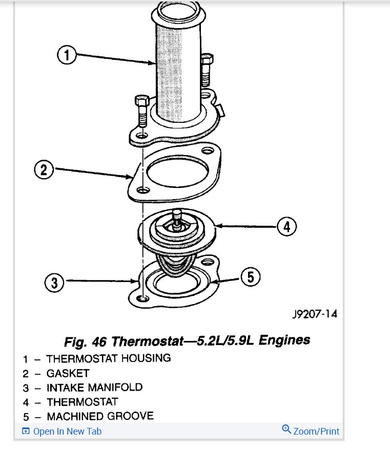

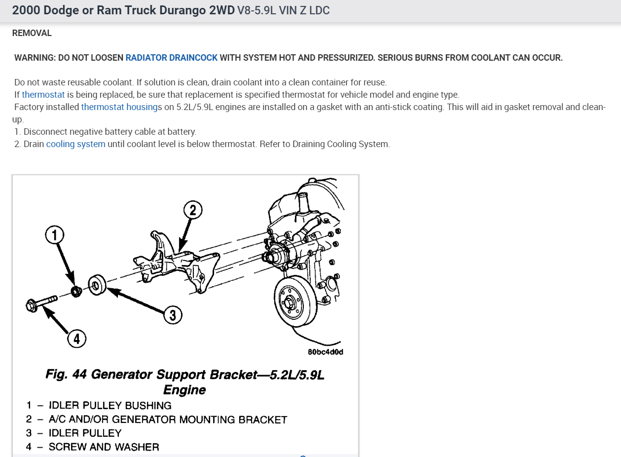

Where is the thermostat located?
Oct 19, 2009 at 11:54 AM
CARADIODOC
  • 34,414 POSTS

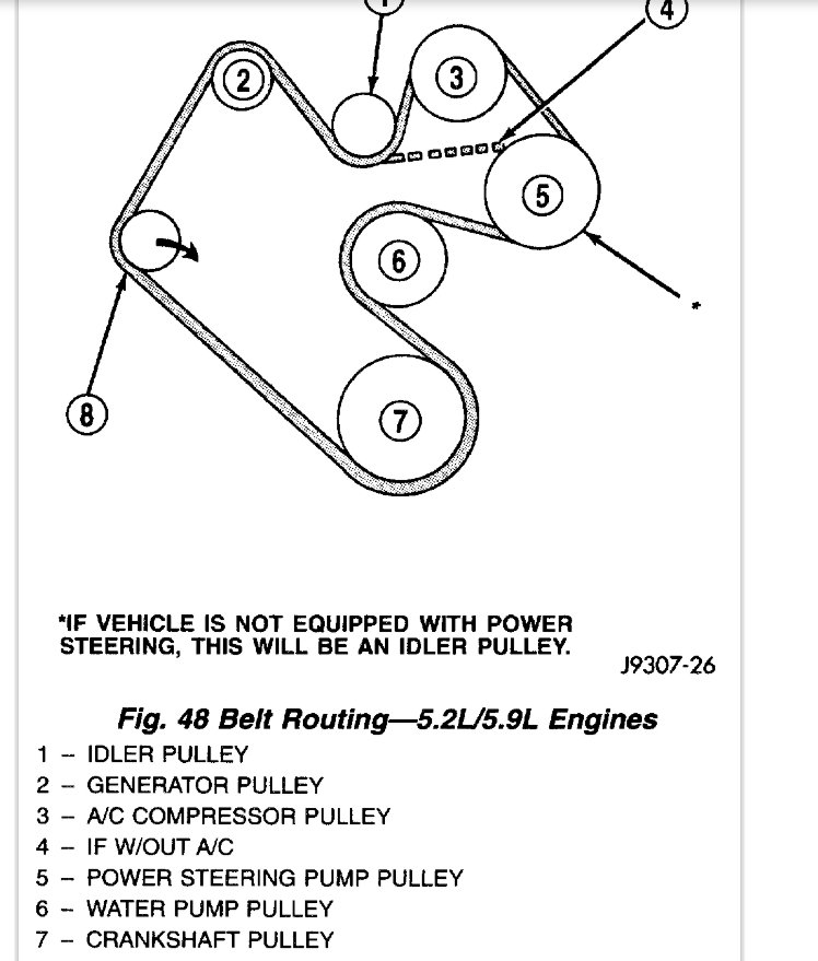

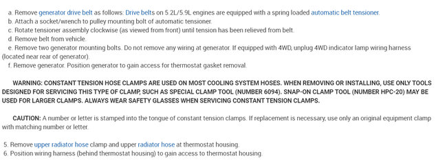

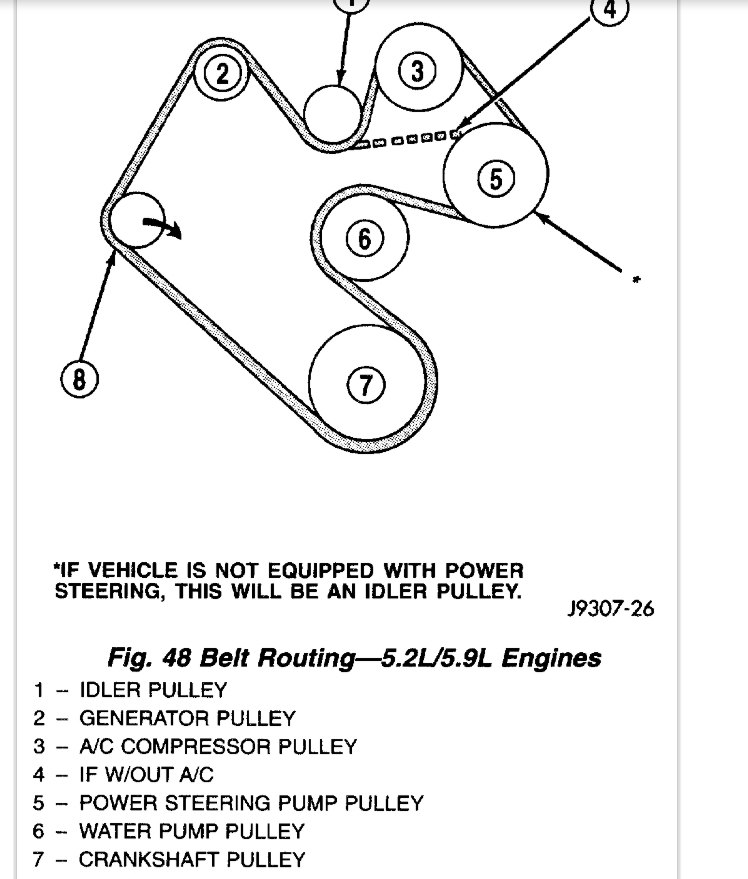

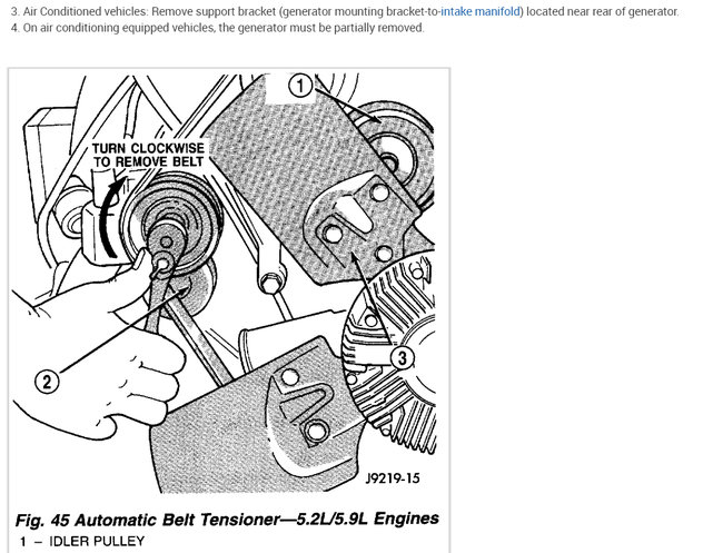

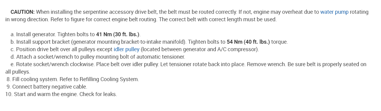

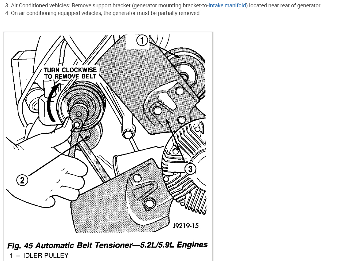

Under the housing on the front top of the engine. The upper radiator hose is clamped to the housing. Here is a guide to help you step by step with instructions in the diagrams below to show you how on your car.
