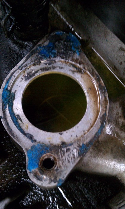

Then everything STOPPED. Things went from bad to worse VERY FAST. Housing for thermostat had broken bolt and was held on with an allen wrench. See photos. Wrench was held by bolt from manifold and was leveraged over top of the thermostat housing. Broken extractor bit inside of broken bolt. No wonder they didn't put a thermostat in it.
Can't do anything until we get bolt removed, but have no idea how to get it out. Can't drill and rethread.

Well, I don't see any insurmountable problems so far. It appears this truck spent a good part of its life with a cobbler who didn't ask for help.
I had a broken bolt exactly like yours on my '88 Grand Caravan a few years ago. It created the perfect "teachable moment" for my students and especially the kid who felt bad for breaking it. You'll need a wire feed welder and an acetylene torch. Propane torch won't work. The flame is too large and not hot enough. Grab a nut with a center hole slightly larger than the bolt diameter. Center the nut over the broken bolt. Use a small torch tip with a nice blue flame with a sharp point. The tip of the flame is the hottest part of the flame. Touch that tip to the center of the bolt to warm it up. The goal is to get the bolt red hot but it never will get that hot because the heat is being sucked away by the intake manifold. Nevertheless, heat the bolt for at least a couple of minutes. Stay away from the nut as much as possible. You want it to stay cool. If you're careful and quick, you can heat the bolt first, then set the nut in place with a pliers just when you're ready to weld. When the bolt is as hot as it's going to get, hand the torch off to a helper and immediately grab the welder. Feed the wire onto the end of the bolt and start to build it up. Stay away from the nut as long as possible. Don't stop welding because you don't want the bolt to have a chance to cool down. As the weld builds, it will fill the hole in the nut and eventually you will also be welding TO the nut. The nut will turn orange. That's ok, but stop welding before the sides of the nut start to melt. You need those sides to be in good shape so a socket will fit on the nut.
Welding works, not by "sticking" to the metal, but by melting the surfaces of the two pieces of metal with a filler metal in between. That's called "penetration". If you don't preheat the bolt, the heat from the welder will be sucked away before the metal of the bolt melts. You'll end up building up the weld until it melts to the nut but it won't have penetrated the bolt. That would be like putting glue on the piece of wood you're using to build a bird house, then assembling the pieces after the glue dries. The preheating gets the bolt up to its melting temperature sooner. It has to reach that temperature from welding before the weld builds up to the nut.
Once the nut is welded to the bolt, let it cool by itself for, ... Oh, ... About ten seconds, then dribble a little water on the nut. Don't pour so much that it floods the surrounding area. You want to shrink the bolt but leave the intake manifold hot. The shock from the water will help break the bond between the bolt and intake manifold. Use a six point socket, ratchet, and extension on the nut to turn the bolt out. If the weld didn't stick to the bolt and you twist the nut off, just grab another nut and try again. I've already had to resort to as many as six attempts before this worked. Sometimes this works better with two people, one to run the torch and one to be standing ready with the welder. Use a high setting on the welder to insure good penetration into the bolt before the weld builds up to the nut.
If that doesn't work, you can also drill out the bolt, even alongside a broken Easy-Out, then install a Heli-Coil insert. If you've never done one or seen one, any auto parts store can show you what to do. The Easy-Out really should be removed to insure there won't be a leak later. You should be able to remove it once a hole is drilled beside it. You'll need to drill or grind the mating hole in the thermostat housing off-center to line up with the new bolt hole. I did this a couple of months ago for one of the bolts for the distributor cap on my '88 Caravan. On mine, the hole went all the way through the mounting flange but yours is a "blind" hole. That means it doesn't go all the way through. You can reach your finger through the thermostat hole to gauge how thick the metal is you're drilling into. Don't panic if you drill all the way through. That just means you'll need some gasket sealer to be sure it doesn't leak, but it will make getting the metal chips out easier. Use compressed air, a magnet, or a little grease on the end of a stick or Q-Tip to remove the metal chips. If there's too many chips left in there after drilling, the tap will but t up against them and won't cut threads all the way to the bottom of the hole. That COULD cause the new bolt to bind at the bottom of the hole and make it appear tight when it isn't really drawn all the way down yet. (To be safe, use a new bolt that is shorter than the hole). Once the hole is drilled with the drill bit that comes with the Heli-Coil kit, you use the supplied tap to make new threads.
Once the tap has gone in a few turns, back it off a quarter turn to break of any chips, then go another quarter to half turn. Keep doing this until you feel the resistance suddenly increase a lot. That means you're but ting up against the chips that fell to the bottom of the hole. Unscrew the tap and clean the chips out again, then run the tap down once more. You'll feel the tap get tight just like a bolt gets tight. Don't force it. I can't remember if your intake manifold is made from aluminum or cast iron. If it's aluminum, it will tap very easily, but it will be easy to peel the new threads off too if you force the tap once it becomes tight. Blow the chips out again so the bolt won't but t up against them.
So, blow the metal chips out after drilling so the tap will go in all the way, and blow them out again after tapping so the bolt can go in all the way. The insert is a wound-up stainless steel spring. The outer part forms threads that match the threads you just cut. The inner part forms threads that match the new bolt. There is a plastic tool in the kit that threads onto the insert, then you use that to wind the insert into the hole. The insert will shrink as you wind it in since it is just a spring. You'll be able to do that with just two fingers. There are two important things to watch for. First, you must wind it all the way in so no part of it sticks up above the surface of the intake manifold. If it sticks up, the thermostat housing will sit on top of it and be held up. There's a chance the gasket won't be thick enough to seal the gap. If you can't get it to screw in far enough, either the hole must be drilled deeper or you can try again with a second insert. Use an air cutoff tool to cut off one or two coils at the top of the insert. What's left will be plenty sufficient to do the job. To remove the first insert, grab the end of the coil with a needle nose pliers and twist it counter-clockwise. If it refuses to unscrew, which sometimes happens, twist and tug on it at the same time to uncoil it.
You can also use a cutoff tool to carefully grind down any part of the insert that is exposed above the surface of the intake manifold.
If you drilled all the way through to the cooling system, wash the threaded hole with brake parts cleaner or carburetor cleaner, then wipe a little gasket sealer inside the hole and on the outside of the insert. Use more sealer on the bolt threads. Stick everything together before the sealant sets up, typically 10 †15 minutes. If you didn't drill all the way through, no sealer is necessary, but you might consider coating the bolt with a tiny dab of anti-seize compound to prevent more trouble in the future. Coat the other bolt too after cleaning the threads with a wire brush. I don't like grease on the bolts because the heat causes it to lose its lubricating properties and it can migrate away from the bolt over time. Anti-seize compound stays put. Be sure to blow out any rust or corrosion from the other bolt hole.
Be sure both gasket surfaces are clean of old gasket material or sealant. When you have a stamped sheet metal thermostat housing, place a sheet of sandpaper on a piece of glass or other smooth surface, then slide the housing across it. There is a slightly raised ring on the housing sealing surface. If you see that entire ring is shiny from sanding, it will seal against the gasket. I also like to put a thin layer of gasket sealer on both sides of the housing gasket. That helps it seal if there are small gouges or sanding scratches from cleaning the metal surfaces. That gasket will peel off easier next time. The Chrysler dealer's parts department has two sealants that I'm real familiar with. The gray stuff gets harder and will seal through a film of oil on the metal surfaces. It is a little harder to clean off the next time. The black stuff remains a little more rubbery but it is easier to remove. It will not bond and seal if there is any oil film present. That makes it not desirable for use on transmission pans.
As a last resort, look for a nearby community college with an automotive program. We had a few dozen people in our community who would sit on a car with a problem for months until it fit what we were teaching, then we used it for demonstrations or to provide the kids real-world experience. They typically will not take your car in if it doesn't fit what they are currently studying because that would put them in competition with the employers who hire their graduates. You would be responsible for getting the truck there, and you could expect to have to leave it for a few days. Often there is a small charge but it will be very insignificant.

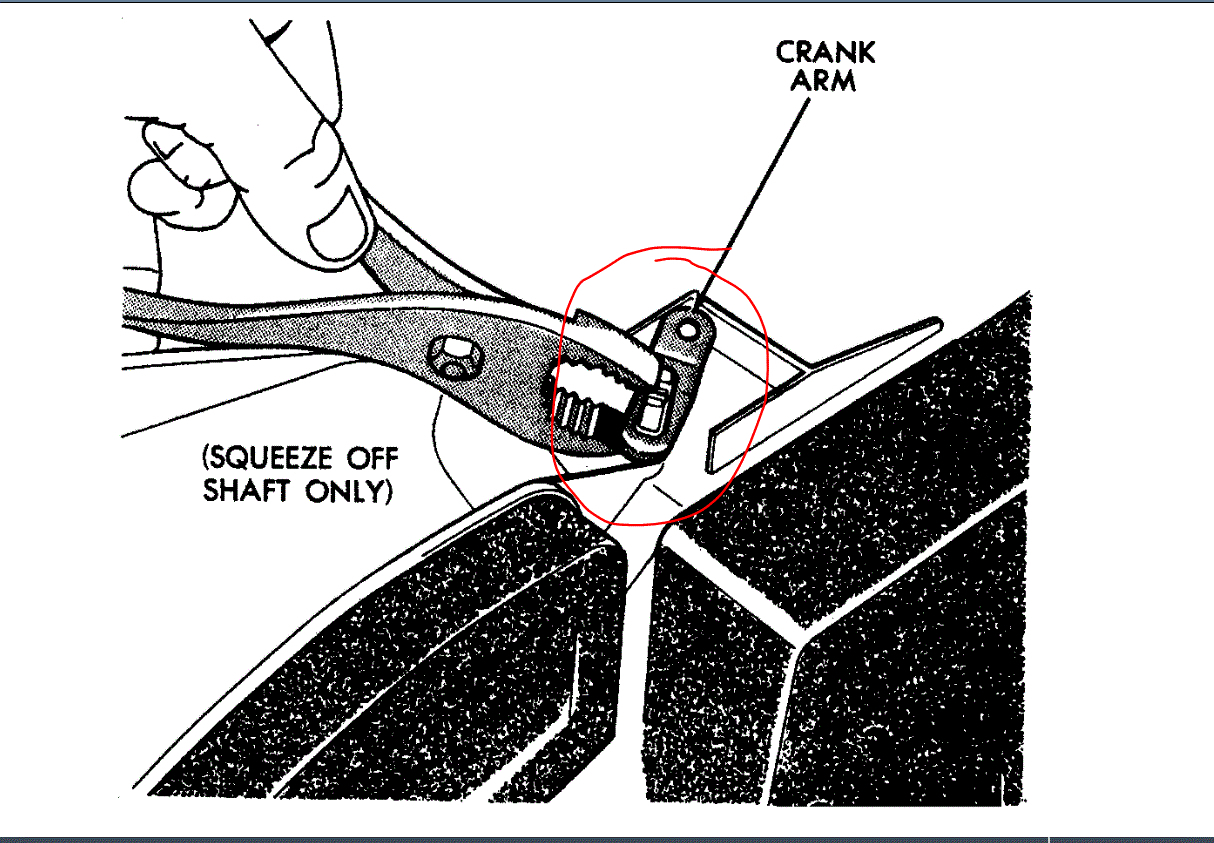

You don't have to replace the entire axle shaft for a leaking boot. Once you have the shaft removed, there are boot repair kits available. I installed a pile of them in my nine years as an alignment specialist at the dealership but I don't recall ever doing one on a Dakota. The kit will include the new boot, the bands that clamp the ends closed and one or two packs of grease. You are to use all of the supplied grease. Depending on the type of band clamps, you might need a special pliers to crimp them tight. Some auto parts stores borrow or rent those tools and they can show you how to use them.

I ended up having to do a heli-coil on the manifold for the thermostat housing. So much easier than all the other stuff we tried before hand. I spent hours dremeling the old extractor bit out of the broken bolt just to nearly break a bigger extractor in it. The broken bolt was just not going to move no matter what we did. The radiator was spewing fluid once it was under pressure so we replaced it. I just wasn't willing to spend one more moment trouble shooting the problem. Went through so much antifreeze before we got it right though. Replaced the upper radiator hose, but all the others were in pretty good condition. Didn't seem to need a new heater coil because the heater worked just fine after getting the thermostat and radiator fixed.

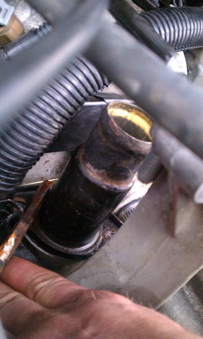

Moved on to the brakes. Not so good. Rear driver's brake line was shot. Went to get the replacement, and they bent it wrong. The gentleman had to straighten parts of the old brake line in order to try and remove the coiled spring that was around it so we no longer have one that is bent the way it needs to be. I had to find a wire coat hanger and spend another hour slowly bending it in the exact way that we need it. I will be going back tomorrow to get another one made. Driver's side rear wheel cylinder was beyond recognition. I am shocked at the state of the entire brake system. We replaced all new pads, calipers, rotors, wheel cylinder, shoes, and one brake line. Unbelievable!

Bending brake lines is a real pain in the butt. I had a brake place bend it for me and the gentleman bent it terribly wrong, plus he had messed up the bends in the original one so I had to bend a coat hanger to match the needed bends in the brake line. Not recommended for a novice like me; it took me forever.
I ended up placing a heli-coil in the manifold where the thermostat housing bolt was broken off. Thank goodness it held.

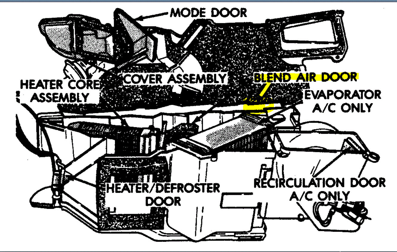

I know my A/C isn’t working, however I would like the fresh air in the cabin on cool nights. I’m only getting heat no matter where I set the thermostat control. What can I check to help fix this? Thank you!

The temperature control on this truck is actuated via a cable. The blend air door, which the cable moves, controls the temp entering the vehicle.
Because of the year, I don't have any specifics as far as pics, but I have done enough of them to walk you through it.
The first thing you need to remove is the trim panel that goes around the radio, HVAC control unit, speedo and so on. There are several (allen type) bolts holding it in place. Remove them and carefully remove the trim cover.
Next, there should be (2 or 3) screws that hold the HVAC control unit in place. Remove the screws and gently pull the unit outward. Note that the cable and wiring will not allow you to fully remove the unit. However, once it is about 1/2 way out, you should be able to see the cable and where it attaches.
Check to see if it is attached, if something is broken and so on. If it appears to be good, disconnect it from the unit and manually try to move the cable in and out to see if you hear the blend air door opening and closing.
I was able to find two pics. The first one (hard to see) shows location of the blend air door. The second shows the lever which the cable attaches to.

Have an 87 dodge dakota. V6. I have replaced all of the big coolent hoses, new therm stat, and red cap. Flushed and back flushed the heater core. Clear water came out. It it did not leak. I still at beast only get luke warm heat.
Tuesday, December 1st, 2020 AT 10:15 AM (Merged)
  • 109,885 POSTS
Is the engine warming to proper temp? Also, with the engine running and hot with the heater on high, feel both heater core hoses. Let me know what you find.
