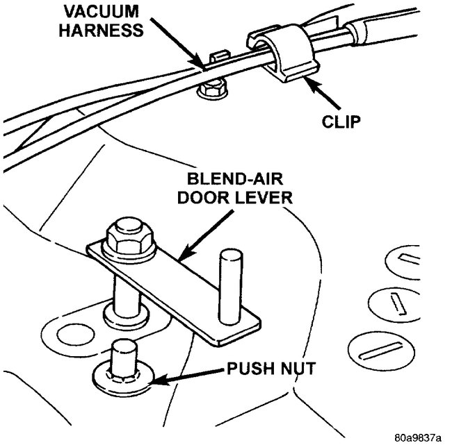

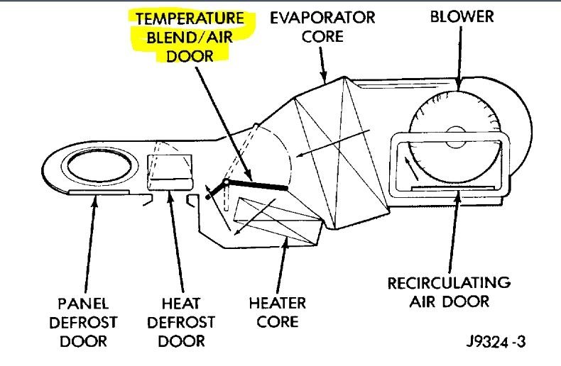

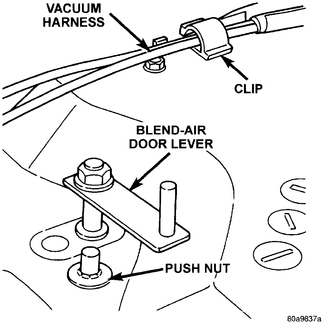

When the engine is at normal operating temp and the heater is on high, do both heater core hoses get hot? If only one does, then there is most likely an issue with the core itself. If both are hot and you still have no heat, then suspect an issue with what is called a blend air door. That is in the vehicle and determines if you get heat or AC into the vehicle. If I recall, the blend air door on this vehicle is actuated by a cable, so make sure it is connected and moving when you change temp. I attached a pic of the actuator lever. Check to see if the actuator is moving the door when you go from cold air to heat. If it doesn't move, disconnect it and move the door by hand to see if it makes a difference. If you do get heat, then either the actuator cable is bad or disconnected at some point.
__________________________
Now, regardless if the blend door works, if there is no coolant flow through the heater core, it won't work. On the other hand, if the core is getting hot and the blend air door doesn't open, you will get no heat. So, do what I suggested first. Engine warmed up, heater on, check to see if both heater core hoses are hot. Do this first and let me know what you find. Also, the heater core will get hot regardless of the hose orientation. Coolant is simply flowing through a small radiator. Let me know if when you flushed it, if water was coming out as fast as you were putting it into the core. In other words, did water flow through it.

Heater hoses by the firewall both should be hot to touch when engine at operating temp if not heater core need to be isolated and flushed
if both hoses hot and no hot air inside suspect blend door actuator
