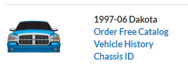

There is a truck parts place in Kansas called LMC truck. They sell truck parts for Dakota trucks so you can look up their website online for parts. I've attached pictures below. Hope this helps and thanks for using 2CarPros.
