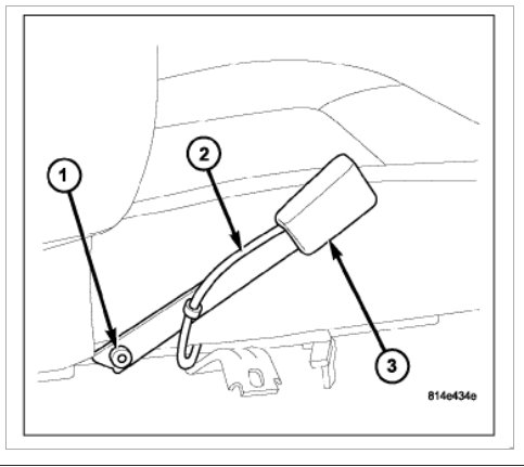

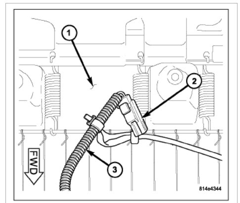

Seat belt warning light
2005 DODGE DAKOTA
32,140 MILES • V8 • 2WD • AUTOMATIC
ANDYA02
When I buckle my seat belt the light stays on. When I start driving and the seat belt alarms 12 times before the alarm stops. The seat belt stays on all the time. How do I clear this problem?

There is a switch in the buckle itself. It must be bad. You can replace the buckle or just join the wires going the buckle.
