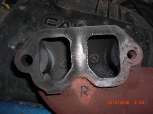

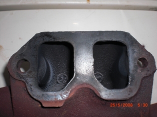

Thanks for your help with my question. As I removed the exhaust manifolds I noticed one of the bolts on the drivers side was already broken off. When I took off the drivers side manifold I noticed what looked like a spot where gas had been escaping. Attatched is a photo of each for comparison. I think that was the problem though. Now I have 3 bolts stuck in my engine that I have to get out. Can you provide some advice as I imagine this is going to be a difficult adventure. I have a tap and die set but I don't have alot of experience in this area. Any advice is appreciated. Also is there any inspection criteria for the exhaust manifolds? Things I should look for/do to them while they are off? Thanks guys I reall appreciate your help!!!!!!!! Mike

If they had broken bolts, you may want to have them surfaced slightly to assure a good seal.As far as broken bolts, that can get tricky and costly if you make a mistake.I use LH drill bits, they spin backwards so that they are trying to unscrew the bolt while you are drilling, sometimes they just back right out.Otherwise you need to use easy-outs once the hole is drilled (down the center of the bolt)
