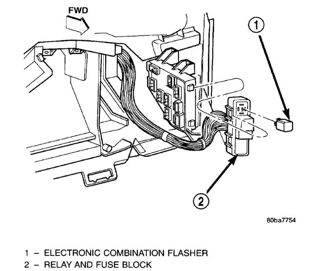

Where is the turn signal flasher located on my truck
Sunday, September 6th, 2009 AT 12:11 PM
5 Replies
JDL
  • 16,098 POSTS
There are two locations, Look on the left end of instrument panel, you may have to open the door. See the diagrams below for location
-3

When I use either turn signal, it comes on and works properly, but after a few seconds, it shuts off completely--Dashboard signal, clicking, and outside turn lights. After a few more seconds, it works properly again without my intervening. Both signals do the same thing. However, it seems that if I turn the hazards on, they work correctly and stay on. All the turn signal lights are functioning- no bulbs are out. What could be causing this?

This sounds like the indicator flasher module has failed,
Although the hazard use the same lights, there is a separate flasher module in use.

When you activate the turn signal, it will blink once or several times and then stop. I replaced the actual fuse, but could not find any signal module. I had replaced the Turn signal switch once right after I purchased the truck, back about 140,000 ago. Could the switch be going bad again, or is there something else I should be looking at first.

I would try replacing the signal flasher before the switch.
