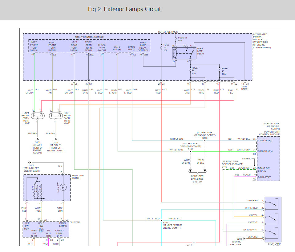

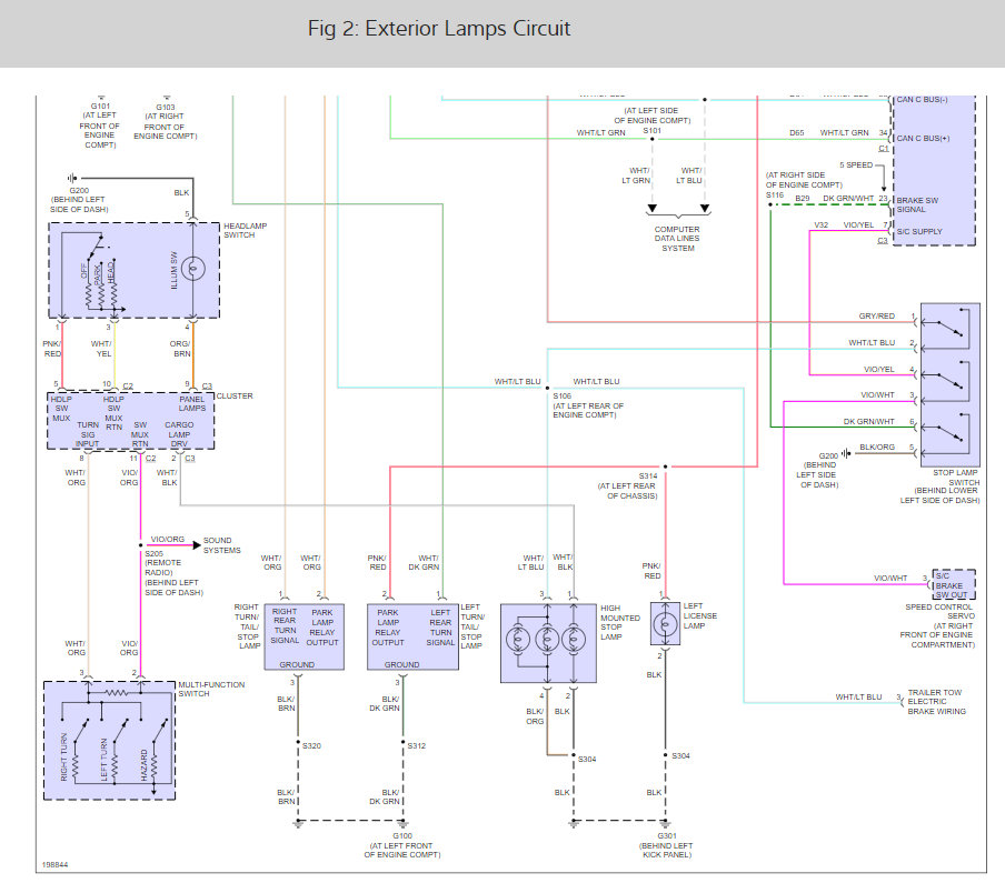

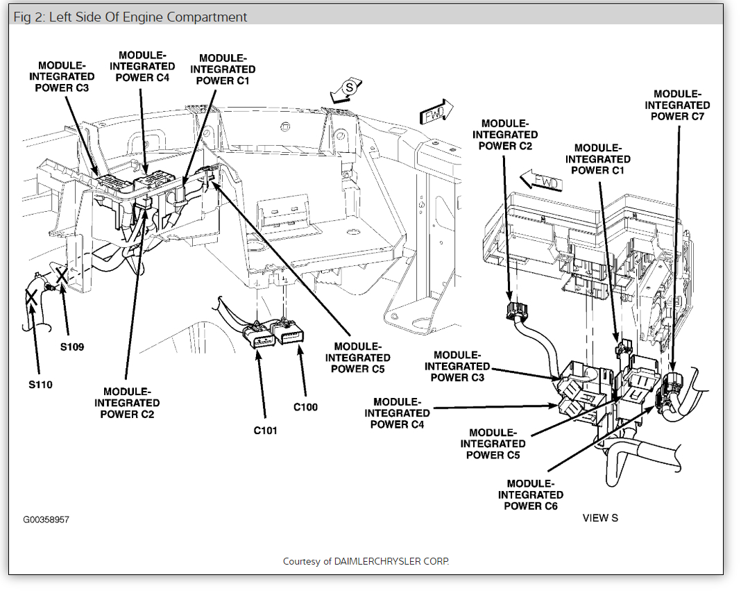

The headlight on indicator is on. It caused me to check vehicle. The flasher is cycling extra fast. I noticed rear left turn signal not working. I cannot find flasher under dash
Dec 10, 2008 at 1:26 PM
  • 110,194 POSTS
This car does not have a turn signal flasher because it is done by the TIPM which goes out all the time. Here is the location and the TIPM and the wiring diagrams for the blinkers so you can see how they work. You will need to have the new TIPM initiated it should cost about $130.00 at a shop.
