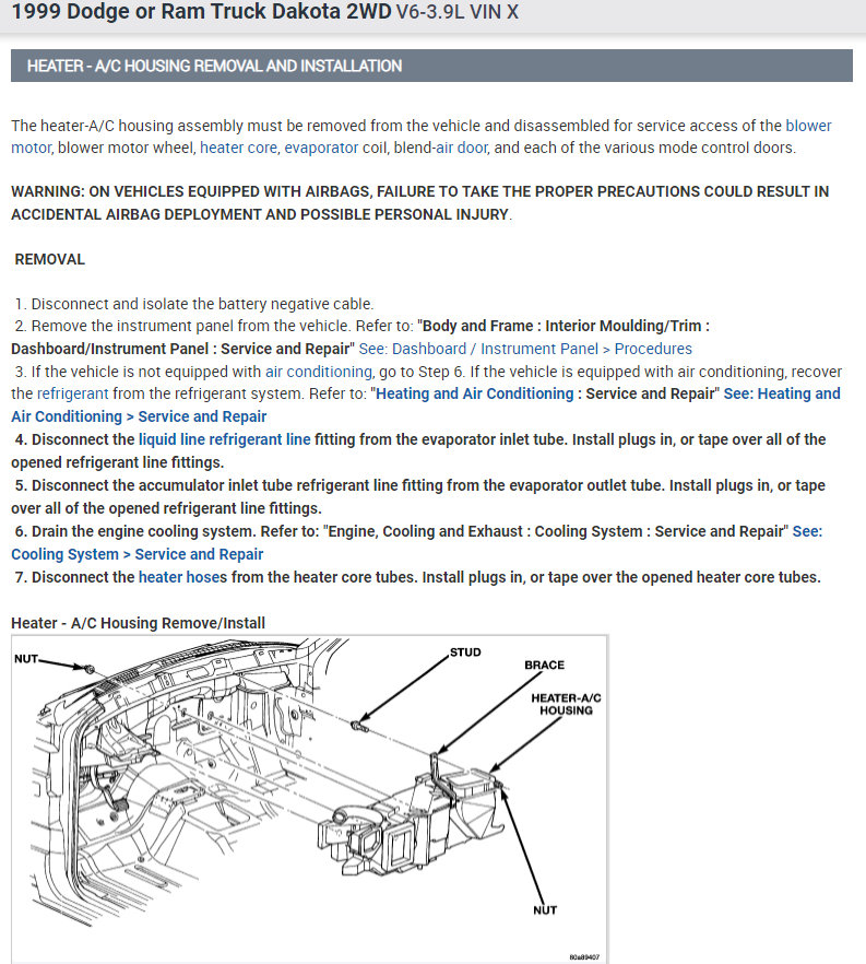

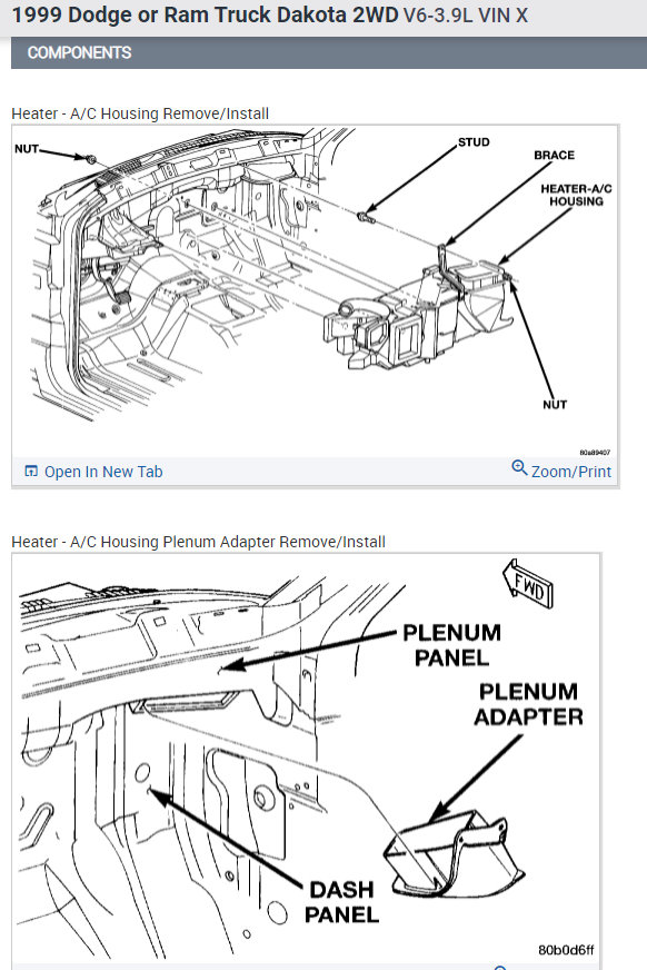

How much does it cost to have the heater core replaced at a shop on average, can I do it myself?
Friday, January 8th, 2010 AT 3:12 PM
SQM
  • 6,383 POSTS

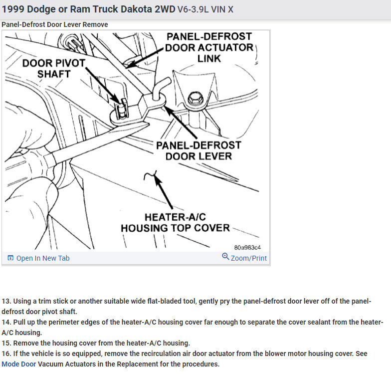

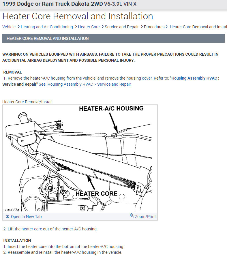

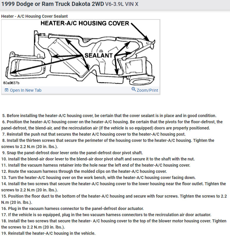

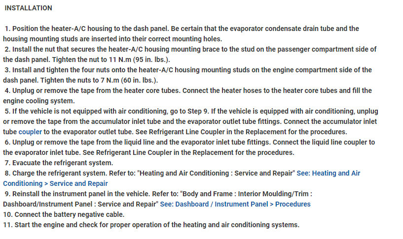

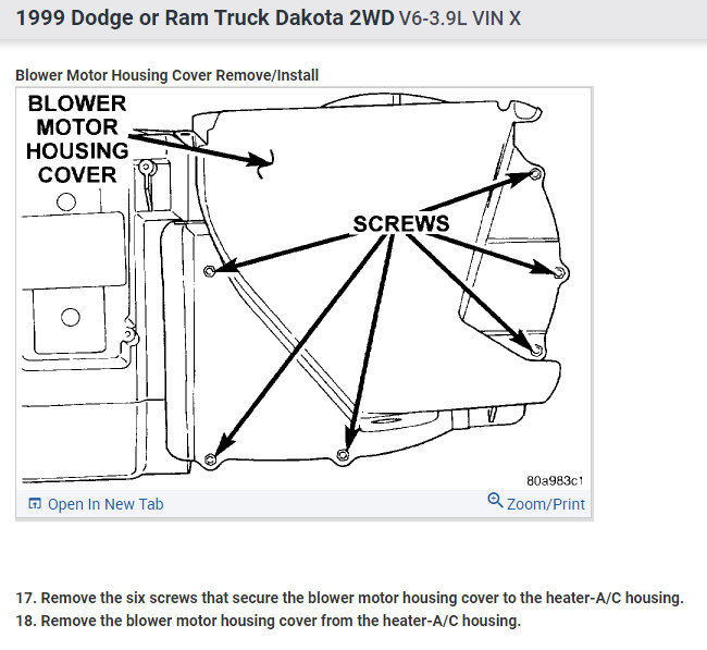

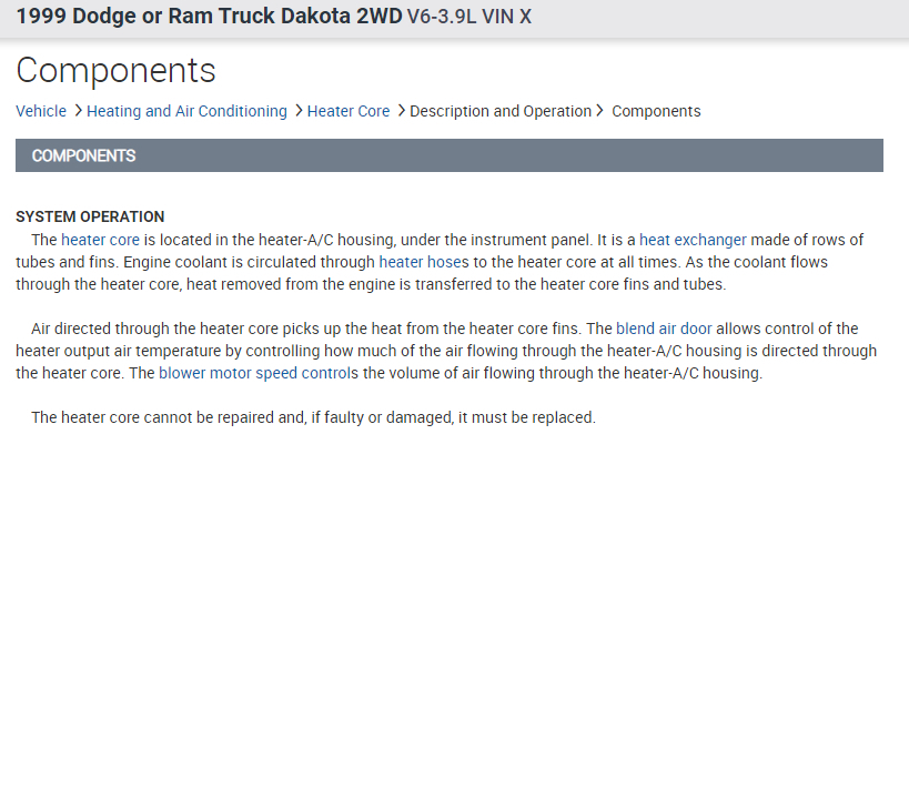

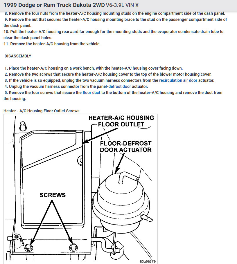

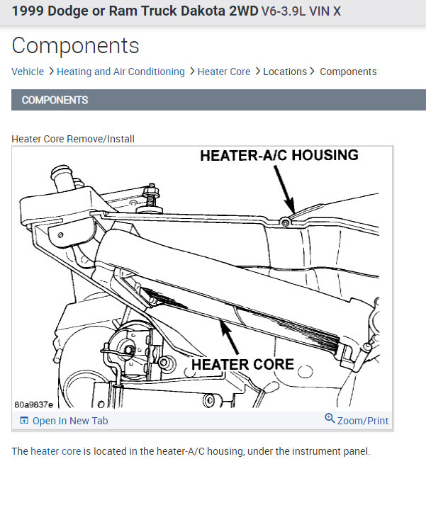

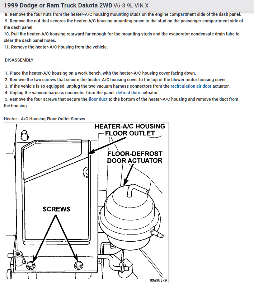

The heater core can be replaced in a few hours depending on your comfort level.
It is located in the heater/AC housing, under the instrument panel.(see diagram).
In order to replace the heater core you will have to remove the heater/AC housing out of the dash. This can be done using simple hand tools.

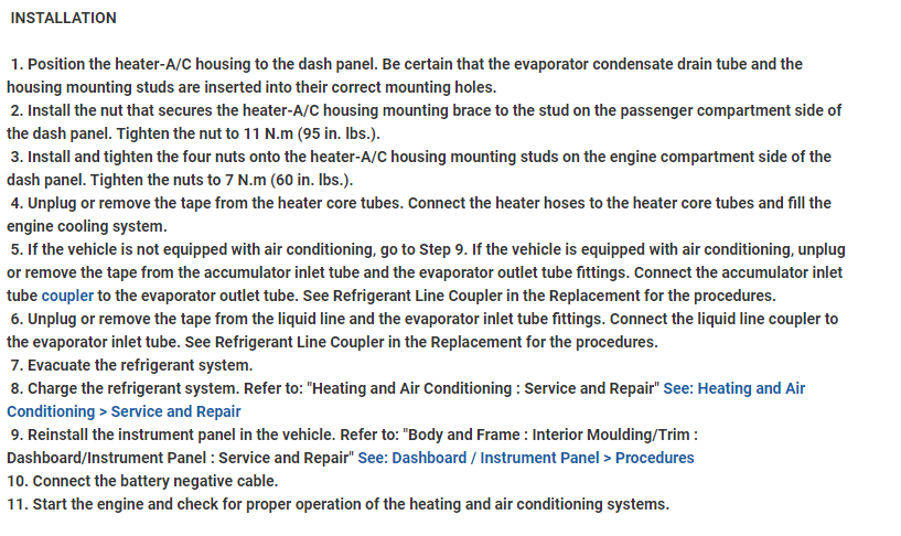

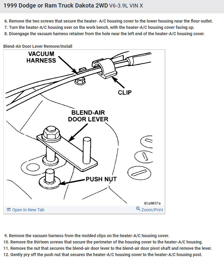

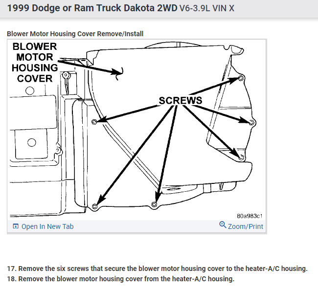

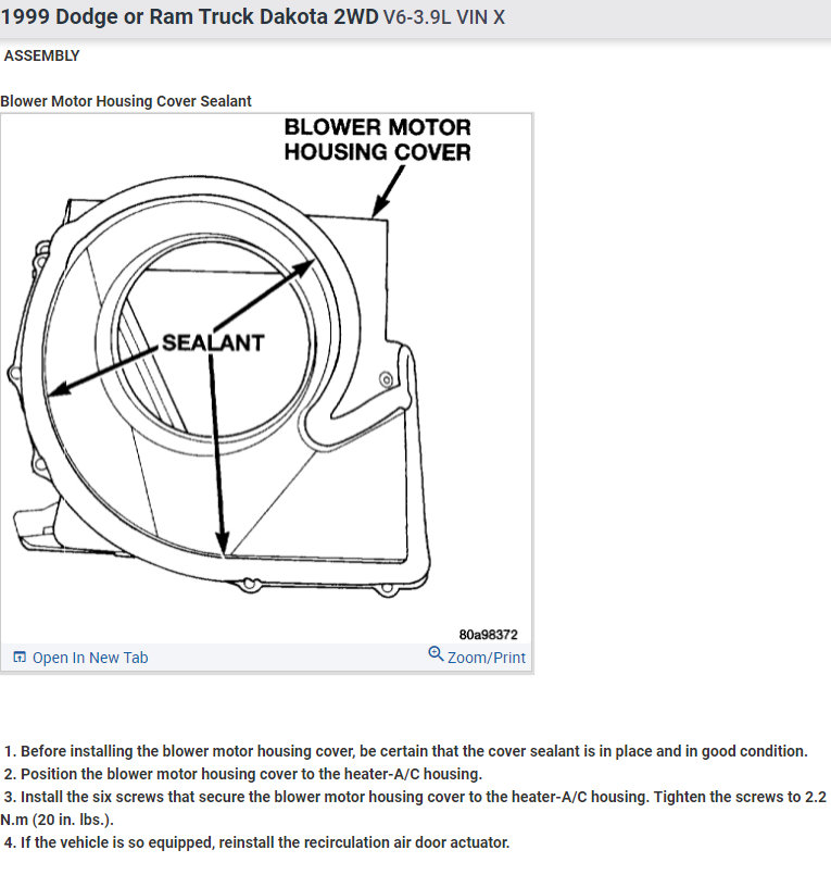

Here is a helpful article on heater core replacement:
https://www.2carpros.com/articles/replace-heater-core
I have included the complete replacement procedure for the heater core as will as the heater/AC housing removal.
