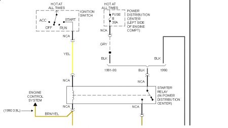

What would cause a starter to bench test fine and then when you put it in the truck it doesn't work at all. I can get it to work by jumping the two terminals on the starter.
Monday, January 13th, 2020 AT 10:38 AM (Merged)
JDL
  • 16,098 POSTS
I'd check the voltage circuits at the starter relay. Voltage for the load/switch side of relay, is hot all the time. Voltage to the coil side of relay, goes hot with the key in the crank position.
https://www.2carpros.com/forum/automotive_pictures/170934_dakota_starter_relay_1.jpg
