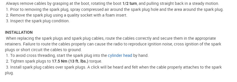

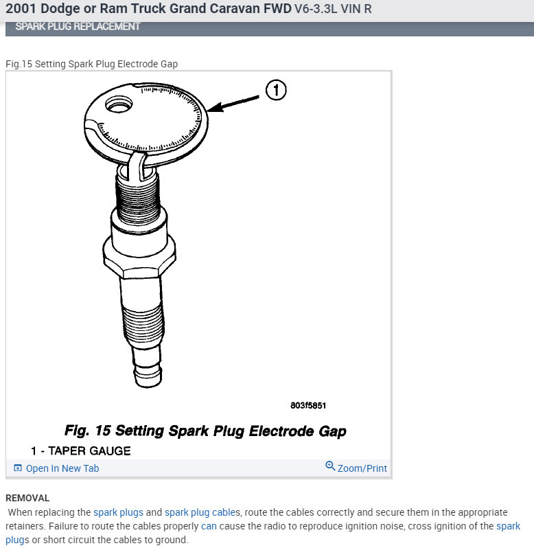

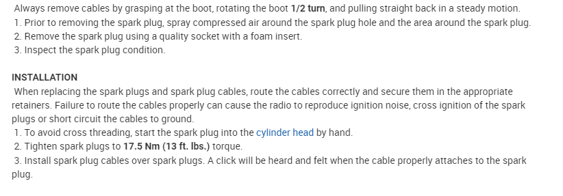

Replacing the rear plugs can be done using spark plug socket and an extension. There is no special trick to that, it is just little difficult to access.
Here is a helpful video that shows how it is done:
https://youtu.be/CE7bM8_j4Zg
