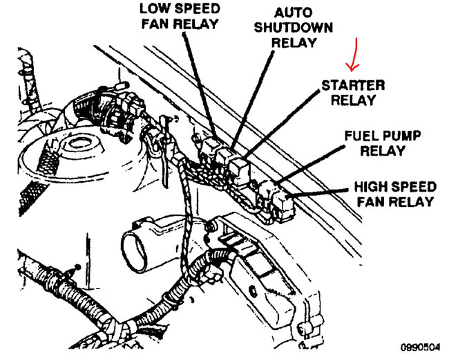

Hi i have a dodge caravan that wont start i took the starter off and had it tested it works fine it just clicks i dont think its the battery because the lights work and the power windows work the blinkers work but the window wipers dont work its a 6 cyl ,3.3L please help

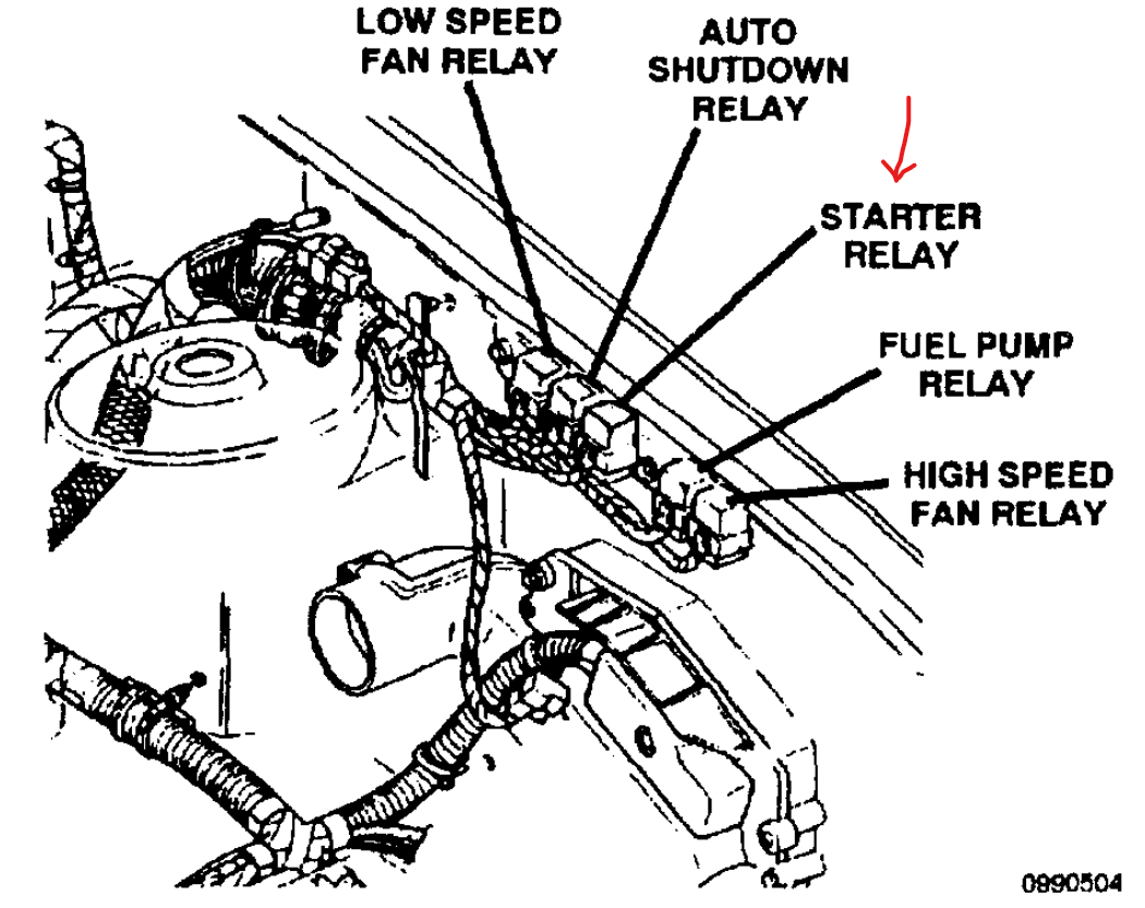

This sounds like you have bad starter relay her is the location so you can swap it out. Check out the images (below). Please let us know what happens.
