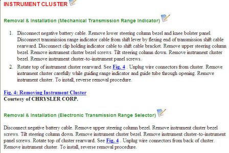

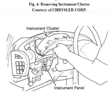

There are cluster problems with these and I think this is where this may be headed. There have a lot of problems with the circuit board connection to pins where the connector plugs in on the cluster. Many techs carefully resolder the connections to restore reliablity. This can also cause a "no Crank".
You can unplug the cluster and see if the van drives better. IF so, look at the cluster or replace it.
It may be a connection problem.
Connectors should be examined at the PCM (powertrain control module), BCM (Body Control Module) and Cluster.

Sounds like 2 different problems. But...
http://www.2carpros.com/forum/automotive_pictures/30961_caravan_cluster_rra_1.jpg
http://www.2carpros.com/forum/automotive_pictures/30961_caravan_cluster_rr_1.jpg
