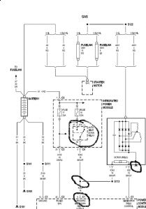

As I was driving down the road the radio turned off, heat turned off, and while hitting the gas pedal the rpms would jump up, this would last maybe 6 seconds then everything would return to normal. When the van "turned back on " there would be a jump in the car as it went forward.

Check the charging system
How is the codition of the belt?
or the auto shut down relay may be the problem
The PCM operates the Automatic Shut Down (ASD) relay and fuel pump relays. The PCM operates them by switching the ground path for the solenoid side of the relays on and off. The ASD relay connects battery voltage to the fuel injectors and ignition coil. The fuel pump relay connects battery voltage to the fuel pump.
A bus bar in the Power Distribution Center (PDC) supplies voltage to the coil side and contact side of the relay. The ASD relay power circuit contains a 25-amp fuse between the buss bar in the PDC and the relay. The fuses are located in the PDC.
https://www.2carpros.com/forum/automotive_pictures/46384_0900c1528021e80a_1.jpg
Is there any code?
check out this diagram.
check for corroded generator ground, or lose.
https://www.2carpros.com/forum/automotive_pictures/46384_0900c15280062646_3.jpg
check your email .
