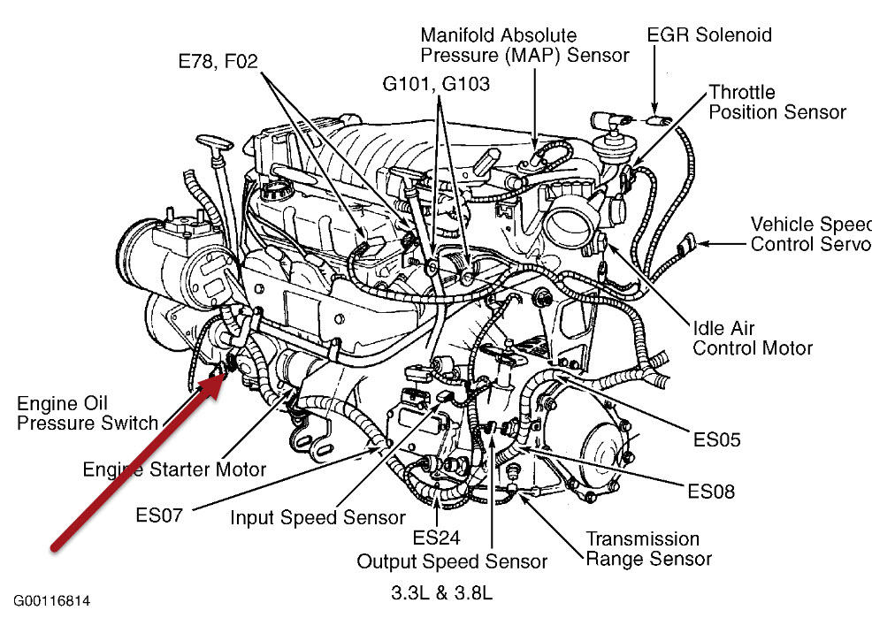

oil pressure sensor
GDERITTER
the oil light and chime going off constantly. The oil level is good. before I brought it in to the shop, I thought I would change the oil pressure sensor. Where is this thing located? Do I need to drain the oil before I do it? Do you think this will solve the problem? Should I bring it in and have a professional look at it?
Feb 12, 2009 at 9:17 AM
  • 75,988 POSTS
Here is a diagrams below that shows its location near the oil filter. Check out the diagrams (Below). Please let us know if you need anything else to get the problem fixed.
Feb 13, 2009 at 1:57 AM
  • 75,988 POSTS
A 3.3L and 3.8L engines its below AC compressor and 3.0 is near the starter

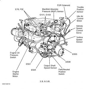

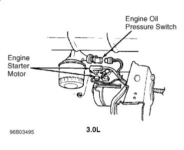

ZACKMAN
  • 4,202 POSTS
3.0L near the starter.
https://images.2carpros.com/forum/automotive_pictures/55316_98caravan30oil_1.jpg
3.3L/3.8L below the AC compressor

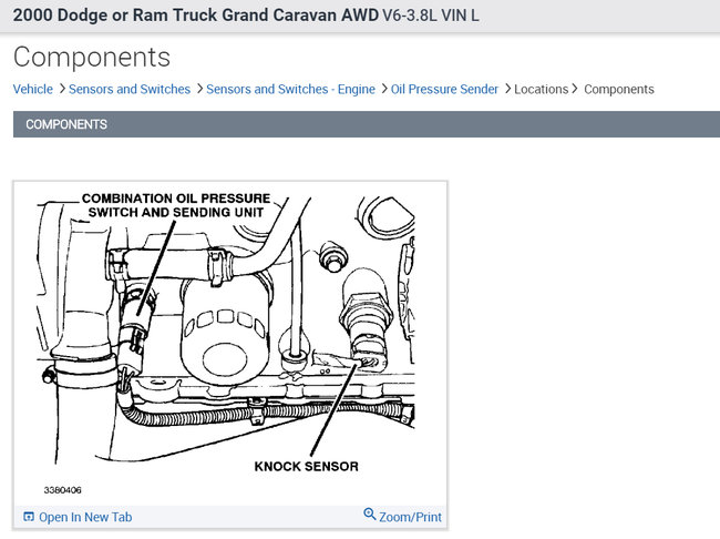

FOOTLOOSEAT163
where is the oil sending unit located on my dodge caravan 3.8
Nov 23, 2018 at 10:45 AM (Merged)
CH112063
  • 1,320 POSTS
hi, its in the front of the engine, below the a/c compressor, ok.
USER NOTE: It's under the back edge of the intake manifold.
LEGITIMATE007
  • 5,121 POSTS
right next to the oil filter. you'll see a harness connected to it

CHANTILLYLACE
where is the oil pressure switch on a 1995 dodge caravan v6 3.0, also can I use synthic oil in a 1995 car?
  • 75,988 POSTS
Don't-Oil Pressure Sending Unit (3.0L) On left side of cylinder block, next to oil filter. On the engine block behind the alternator.

HMAC300
  • 48,601 POSTS
if you are talking about the oil pressure switch see pic. there is no oil sensor

Yes this could be the oil pressure switch infact that is the first thing I would change. You should be able to do it your self. It should be next to the oil filter. This is what it should look like for the 3.3ltr and 3.8 ltr engine.
https://images.2carpros.com/forum/automotive_pictures/249564_275888_1.jpg
Hope this helps you.
Nov 23, 2018 at 10:46 AM (Merged)

JTODD12
It was fairly simple to replace and I haven't had one single "ding, ding" since! Thank you again...what a great site and service.
