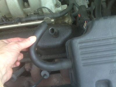

MYUSEDODGE1
1998 Dodge Caravan 6 cyl 125000 miles Totally mechanically challenged so bear with me. I have the above mentioned caravan and there is a black tubing coming from air filter container to top of oil tank. Looks like it has been cut or broken and also looks like it had been repaired with black tape. Started feeling like it was not getting fuel the other day. Next day would not start and looking under hood found the tubing in two pieces and tape sticking out of the tubing coming from oil tank. What is this tubing called and where can I purchase it to replace. Thanks!
https://images.2carpros.com/forum/automotive_pictures/406073_pvcIMG00179_1.jpg
Jun 1, 2020 at 7:11 AM (Merged)
D.ARBIT
I had this exact problem the other day. Just go to your local kragen or auto zone and get a 5/8" hose. I bought a heater hose and installed it no problems. And its very cheap. Cost me around $2.

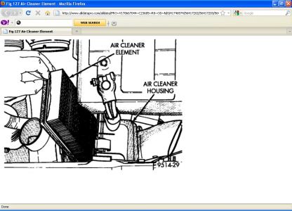

Hi there,
Could you please guide me how to change the air filter on my dodge caravan, as where is it located and how to go about it please. I found it complex as compared to my toyota camry which is easy to change. Also I have two types of air filters in market, one is white colour and other is like orange colour, i drive in city usually, not highway.
I would appreciate your guidance in both the matters.
Thanks.

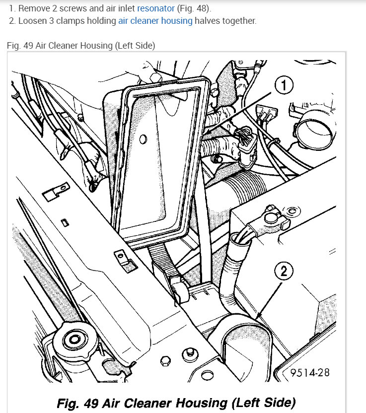

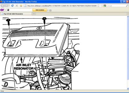

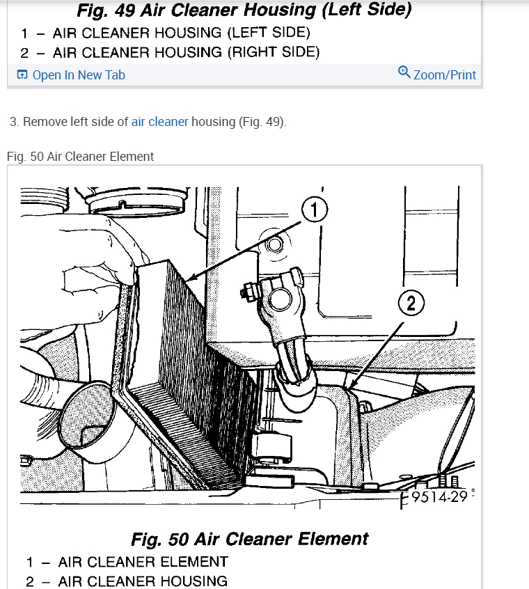

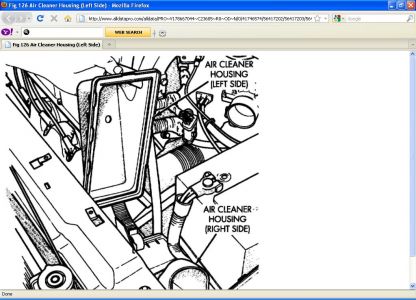

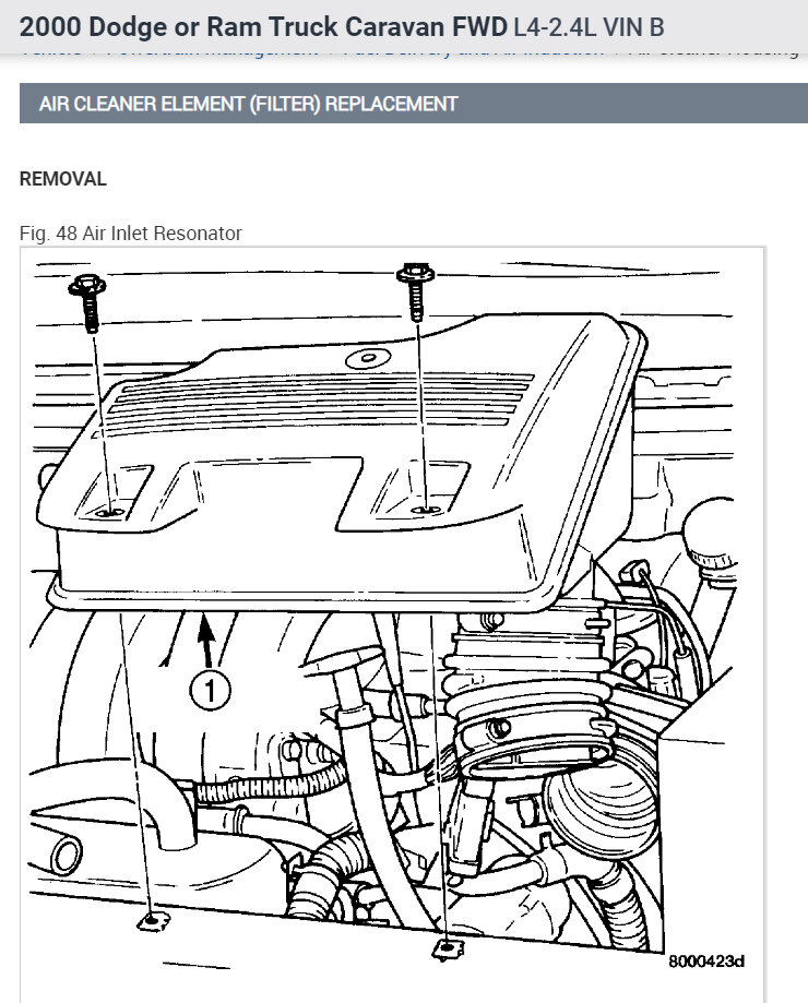

SATURNTECH9
  • 30,868 POSTS
https://images.2carpros.com/forum/automotive_pictures/416332_1996_dodge_carvan_air_cleaner_replacement_part1_1.jpg
https://images.2carpros.com/forum/automotive_pictures/416332_1996_dodge_carvan_air_cleaner_replacement_part2_1.jpg
https://images.2carpros.com/forum/automotive_pictures/416332_1996_dodge_carvan_air_cleaner_replacement_part3_1.jpg
REMOVAL 1. Remove 2 screws and air inlet resonator (Fig. 125). 2. Loosen 3 clamps holding air cleaner housing halves together. Fig 126 Air Cleaner Housing (Left Side) 3. Remove left side of air cleaner housing (Fig. 126). Fig 127 Air Cleaner Element 4. Remove element from air cleaner housing (Fig. 127). INSTALLATION 1. Install a new element in housing. 2. Position left side of housing. 3. Snap clamps into place. 4. Install hoses and air inlet resonator. There is your instruction's i have never seen a orange air filter element maybe you mean a orange border air filter.I would just get a fram one there really good.
CHABOOJAN
wow, i am amazed the answer with diagrams, impressed. Will accordinlgy.
Thanks for both the answers.
