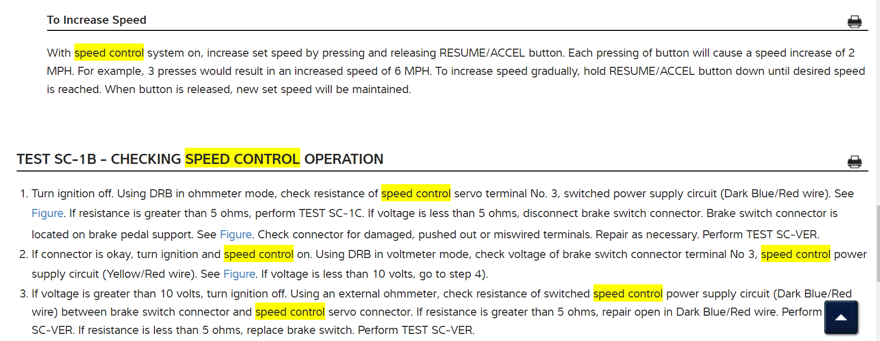

Cruise control stopped working cannot find fuse location.
Monday, September 21st, 2020 AT 7:36 PM (Merged)
SCGRANTURISMO
  • 4,897 POSTS

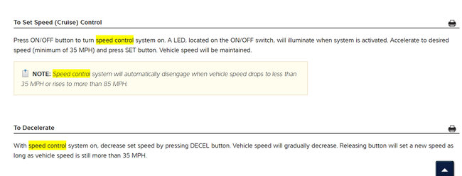

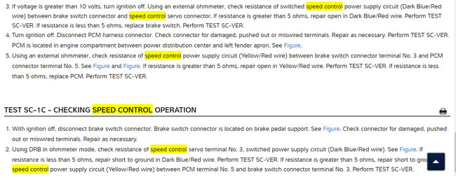

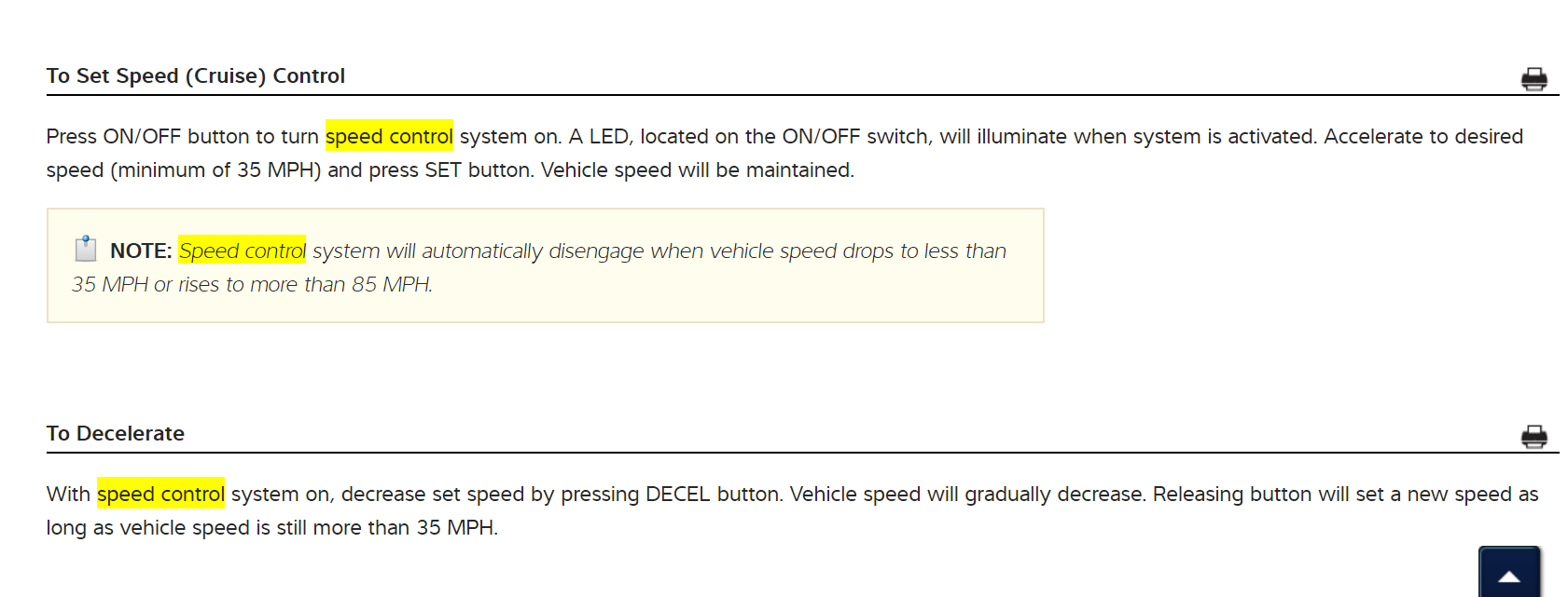

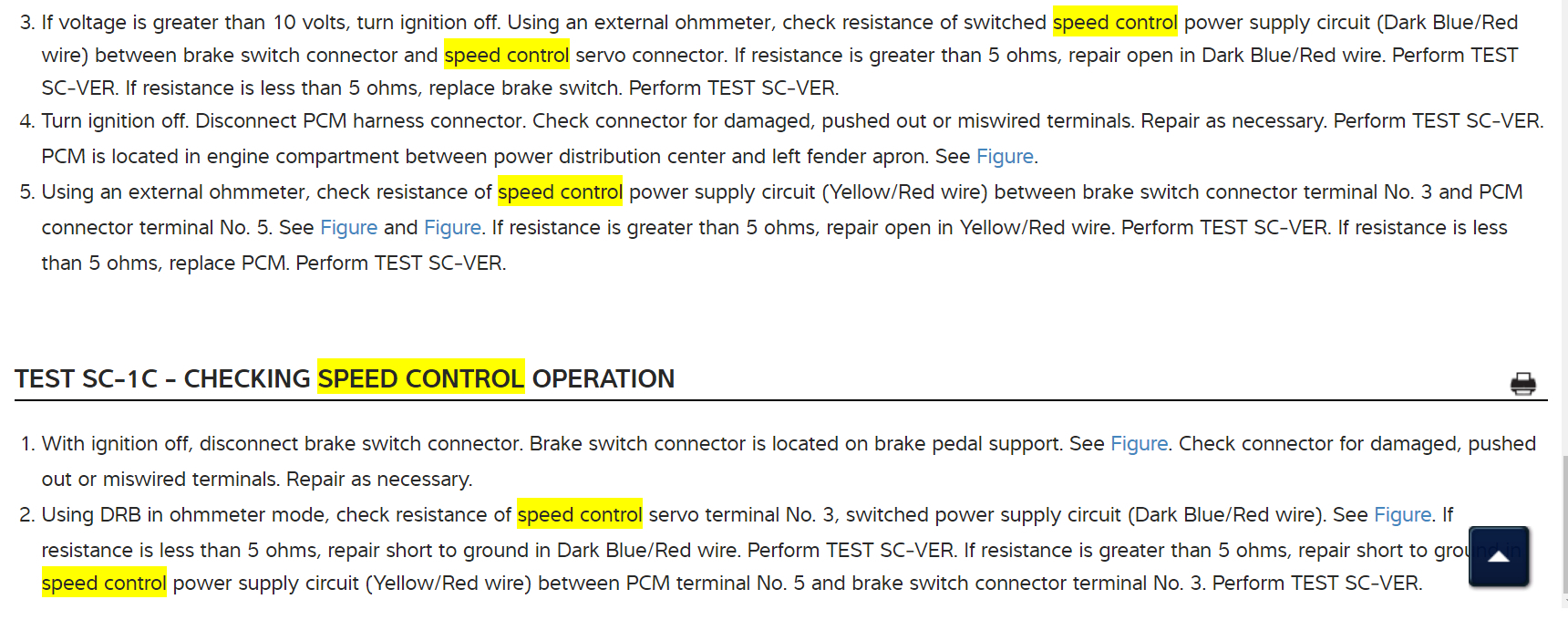

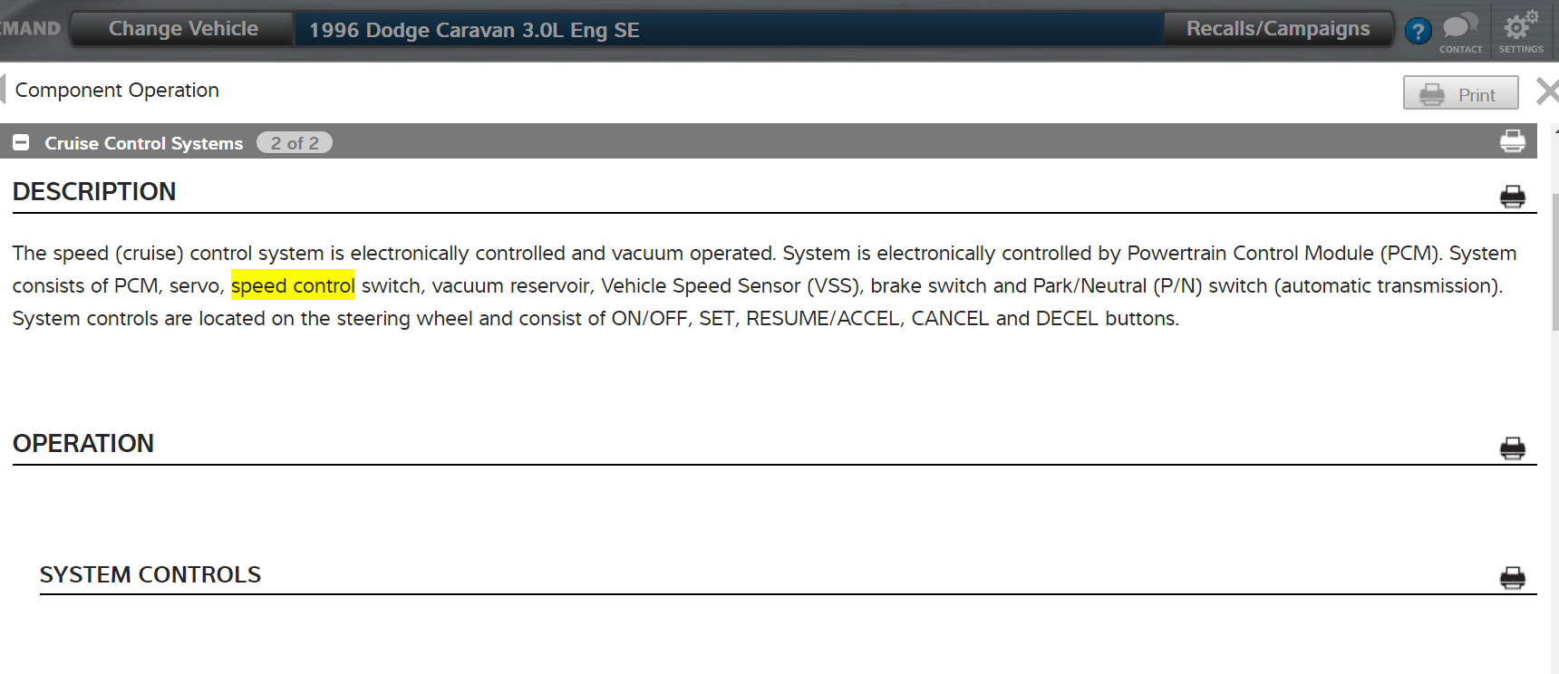

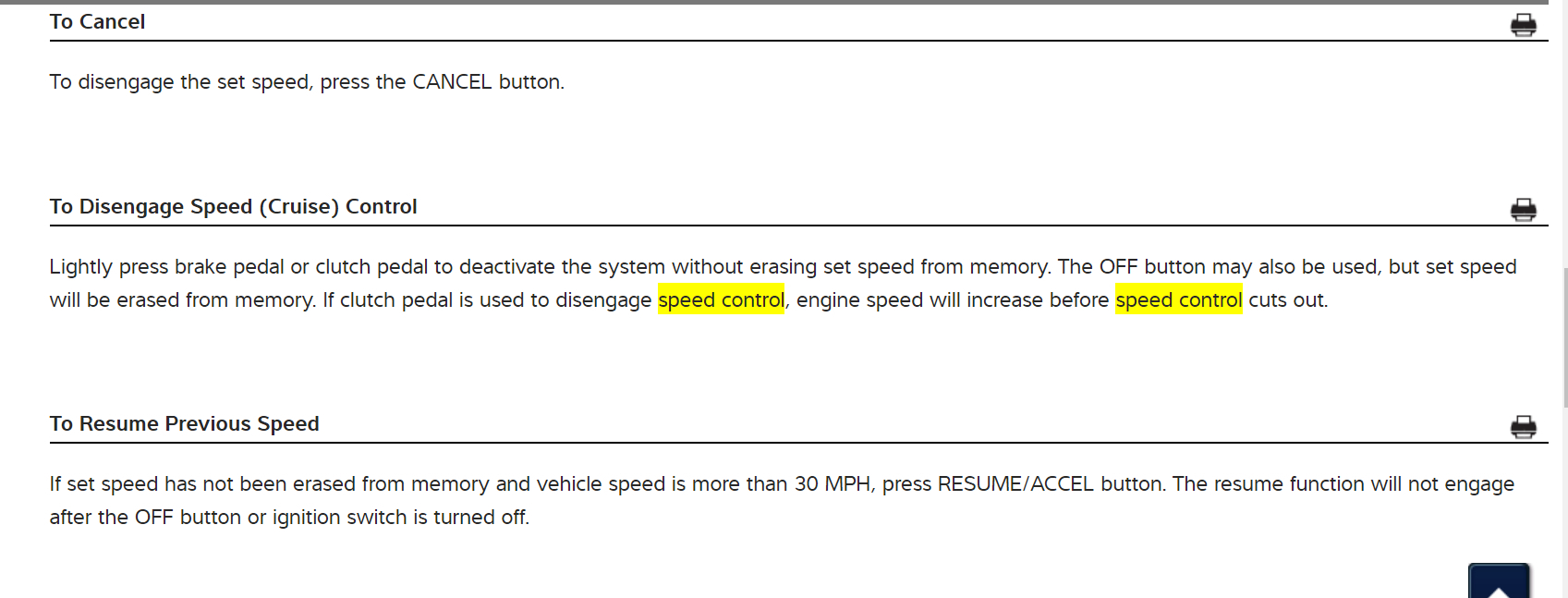

There is no fuse for the cruise control operation on your vehicle. The electronic control is handled by your vehicle's Power-train Control Module (PCM) or "computer" and as such, does not require a fuse to protect a separate circuit. I have have included in the diagrams down below a description of your vehicle's cruise control system as well as a couple of factory diagnostic tests to figure out what is going on with the system. Please go through this guide and get back to us with what you are able to find out.
Thanks,
Alex
2CarPros
