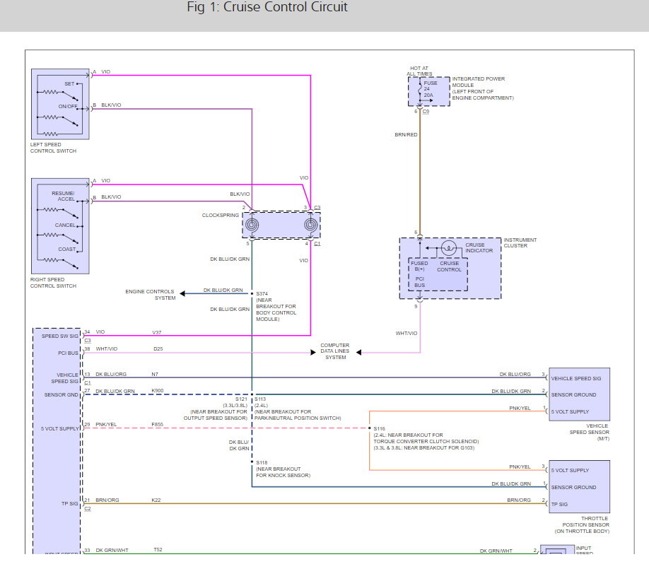

My cruise control is not working. I replaced the fuse and no help. every time I remove this fuse It works for a little while. can you help ? Is the a relay that is involved and which one. Thank you
Doug
Aug 12, 2010 at 11:57 AM
  • 110,194 POSTS

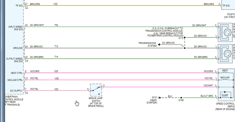

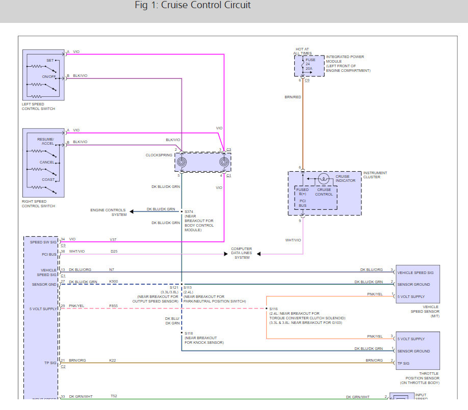

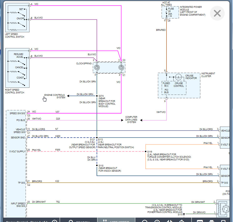

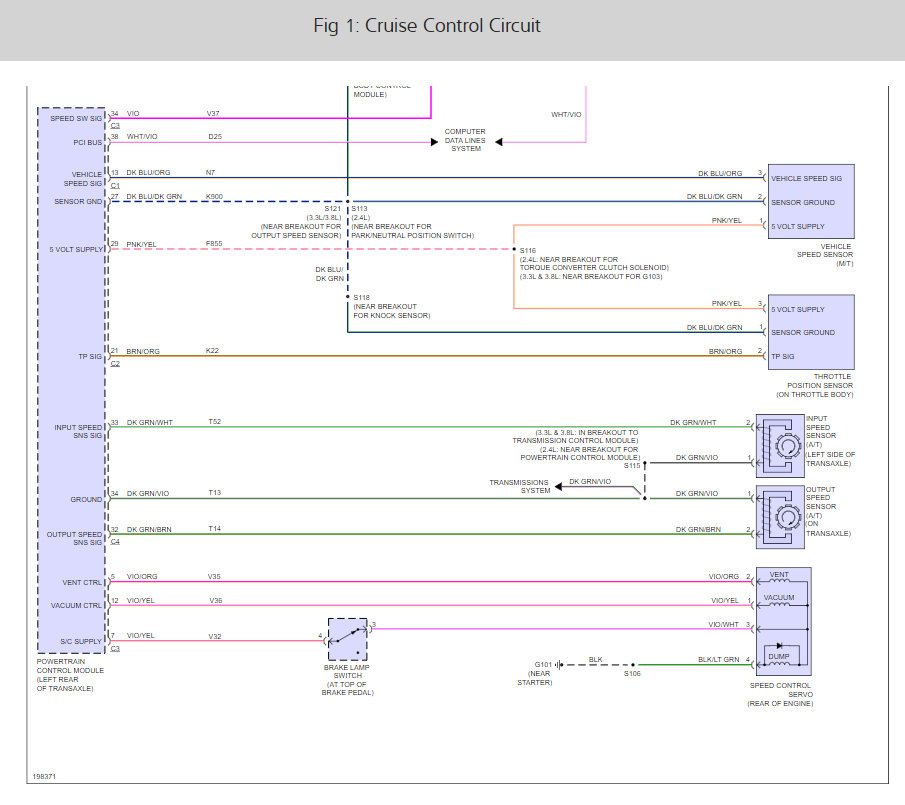

It sounds like the clock spring in the steering wheel is going out which is common. here is a wiring diagram so you can see how the system works and a guide to show you how to replace the clock spring.
https://www.2carpros.com/articles/steering-wheel-clock-spring-removal
Cheers
Aug 12, 2010 at 3:58 PM
DHIBL2
I got the part for $78.00 and installed it all fixed. Doug

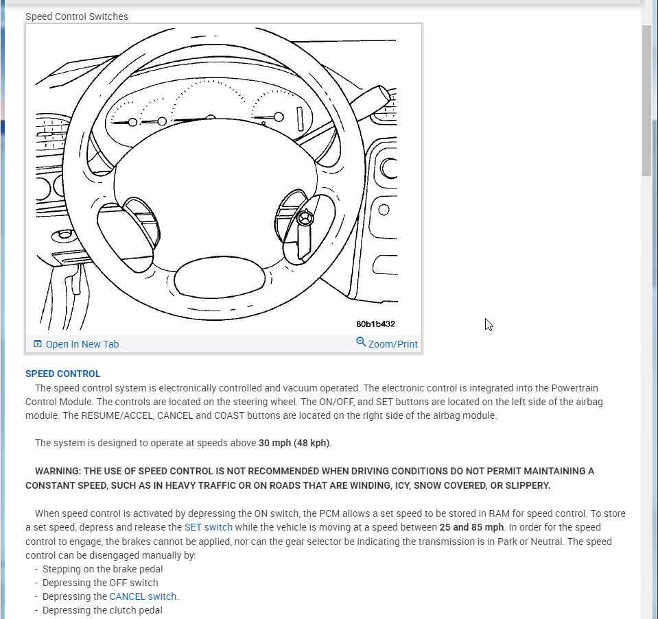

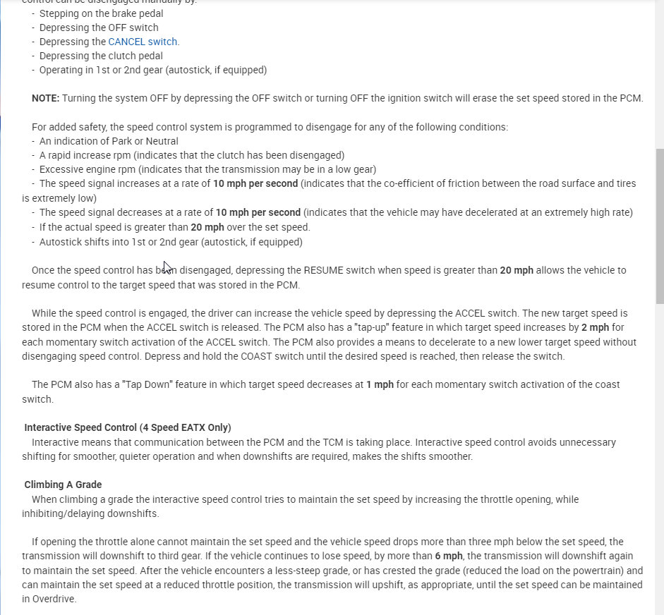

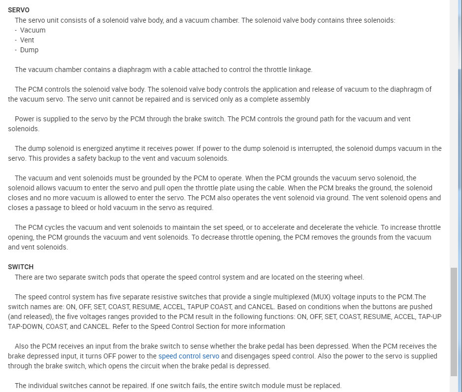

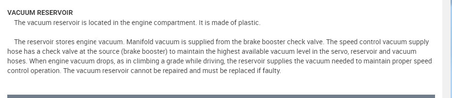

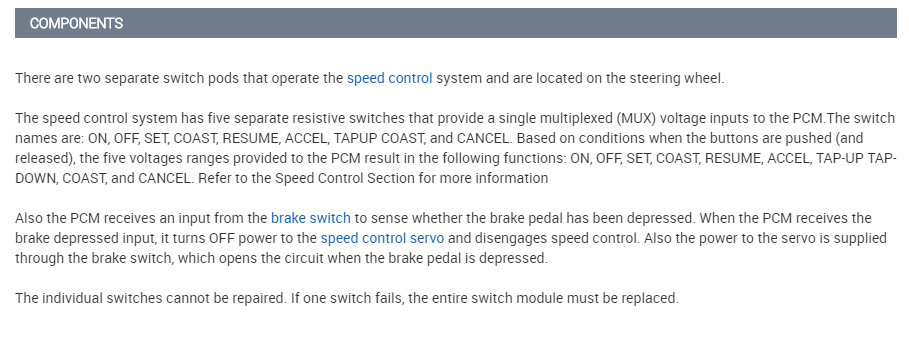

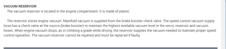

Assuming that because you said the horn is fine, your switch is operating and the cluster shows the cruise is on but it just doesn't engage?
If this is the case, the issue is most likely the brake switch or the servo.
I attached a bunch of info. The main thing we need to check is if the brake switch plunger is sticking. This means the PCM thinks the brakes are being depressed even when they are not. Usually it is not enough to turn the brake lights on but this is the most likely cause. If it were me, I would replace the brake switch and go from there.

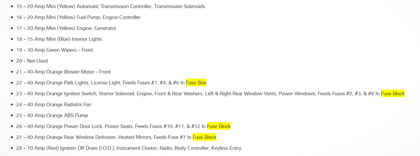

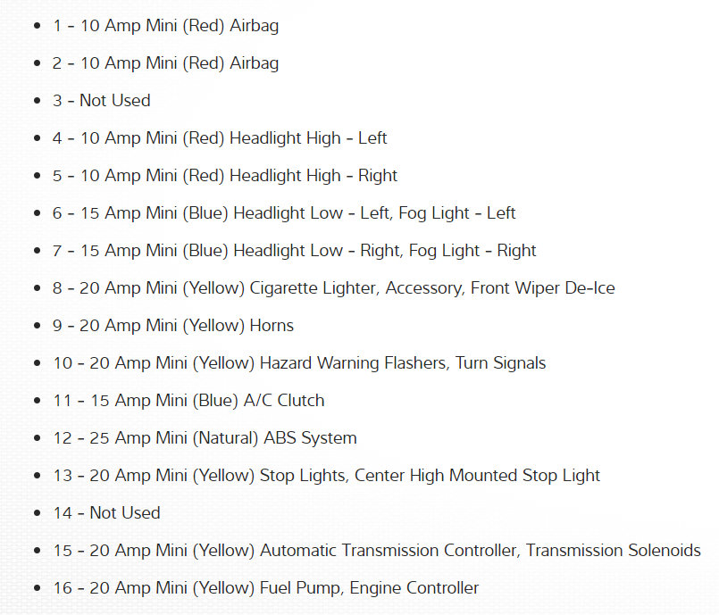

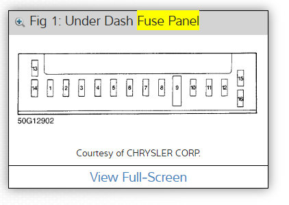

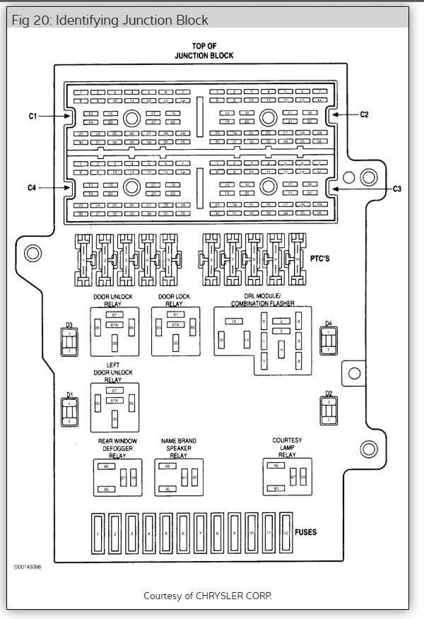

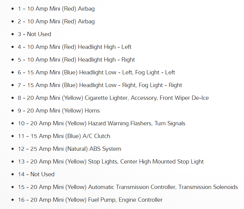

CARADIODOC
  • 34,321 POSTS

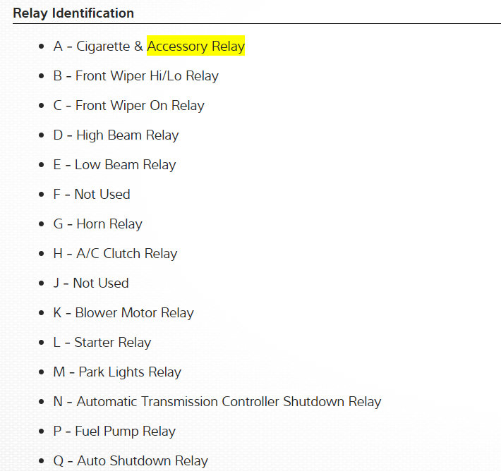

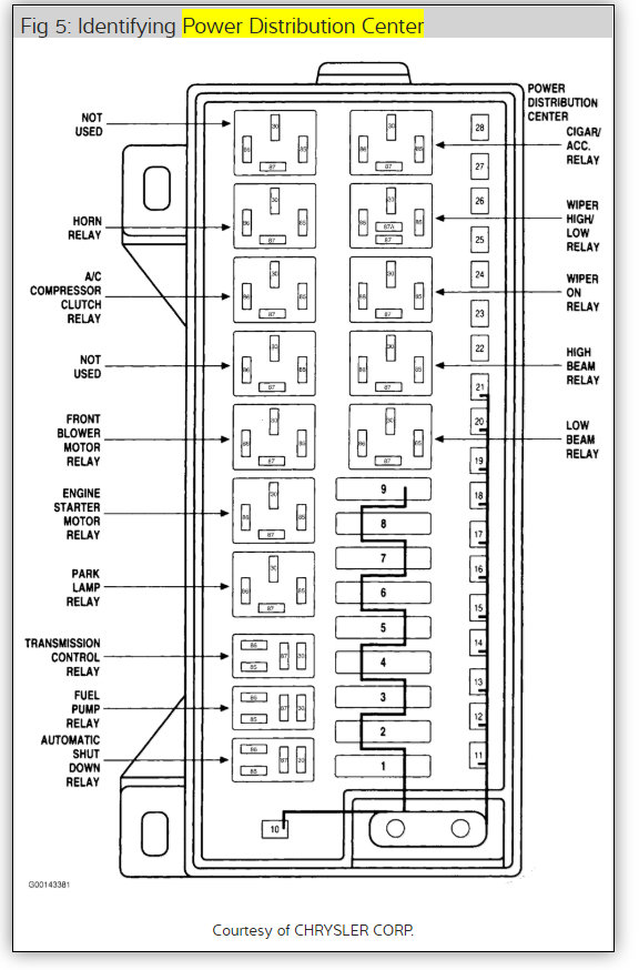

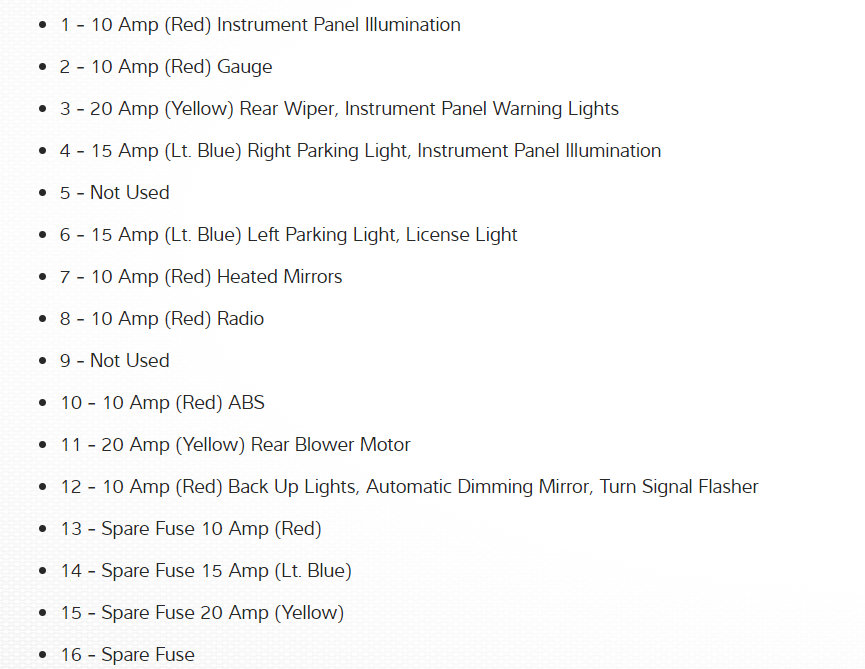

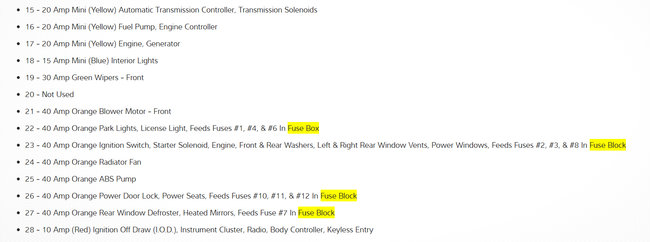

Hold up the brake pedal with your foot. It the cruise works, check the adjustment of the brake light switch. if okay 9 times out of 10 it is the clock spring behind the steering wheel. Also lets check the fuses first. Here is a guide and the fuse location.
Sep 21, 2020 at 7:32 PM (Merged)
OMONTES7
Hold up the break pedal while idling or with the van off, Or while driving, I'm getting a test light for the fuse
CARADIODOC
  • 34,321 POSTS
While you're driving when the cruise control should work which is typically above 35 mph.
OMONTES7
Thanks Very Much is was the fuse :)
