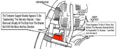

I just cannot remove or loosen the Alternator Bracket even though I the Alternator is completely disconnected from the car.
https://images.2carpros.com/forum/automotive_pictures/515411_1997_Dodge_Caravan_46384_new2_2x1_1.jpg
[img] The Tensioner Support Bracket Appears To Be "Sandwiching" The Alternator Bracket. I Have Removed Virtually All The Bolts From The Bracket But It Will Not Move And Any Direction. There Appears To Be A 15mm Nut Behind The Alternator Bracket Which Is Impossible To Access. I can feel it, but not see it..

It is written there"deep socket" ?
you need deep socket to get to it.
It is also written"pivot"
you need to pivot what is in your way to get the deep socket inn there.
Am I right or wrong?

In reviewing your response, Yes, It does say Deep Socket", however, I believe in the illustration it is referring to the Alternator's Bottom Bolt.
The illustration, that I updated, highlighting in Red the - Serpentine Belt Tensioner Assembly - which is, I believe holding the Alternator Bracket against the motor making it impossible to move. That is the problem I am experiencing. There is virtually no access to the rear area of this assembly that I can just barely touch and feel a 15mm nut holding it on. I cannot see it from under the car and can just feel of it from the top. There is no way to apply a Deep Socket to it. If any thing, a shallow swivel flexible socket would be needed to affect it removal. That's why I am seeking assistance, technique and advise from someone who has done this repair before and knows just what I am up against.
Additionally, I have removed the Tensioner-Pulley to provide more room. But the clearance between the engine and the inside fender well is just not large enough to extract the alternator. There is just no vertical clearance to remove it from the top. The windshield wiper panel is blocking that area along with the AC lines running over the alternator.
I need to resolve this issue as soon as possible and cannot proceed as it stands now.

On the 3.3 and 3.8 Mit1 ondemand5.com says you have to remove the windshield wiper housing,accessory belt, and generator mount bracket

there is a pivot bolt and it has spacer.It must be removed .Do not drop spacer when removing it.
try a swivel flexible socket to get behind.

I did mine not too long ago. Twice, in fact, after the alternator tested good then conked out again after I put it back. The second time was pretty easy. I'll look later tonight to refresh my memory. As I recall, I removed the tensioner but later found I didn't have to, that the bracket goes around it but not under it, as it appears. The tensioner has a 15mm bolt through the center of it that, best I remember, unbolts from the back of the lower, cast aluminum portion of the bracket. The trickiest part was getting the 8mm nuts off for the power steering reservoir and line and, after getting I think three 15mm bolts out of the front of the bracket, finding I had to jimmy it back and forth and pull pretty vigorously to slide it out from between the lower bracket and the front cover. It was kinda wedged in there. B**ch, ain't it? I had to work both underneath the car and sitting up in the engine compartment.

I just did this the other day with my 2000 dodge grand caravan 3.3l. You have to remove the belt tensioner. That is what is holding the bottom of the alternator bracket in place. In order to get to the belt tensioner nut on the back, you have to move alternator out of the way as much as you can. Some say you can get to the nut from underneath. I did it from the top, and was not easy. I used a 15mm wrench.
