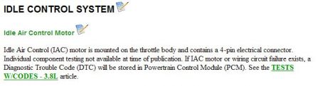

If once you get it moving down the road and it runs and drives okay, it is not a fuel pump or filter problem. I would look at the idle air control (IAC). This little unit is supposed to compensate for added engine load ie. in gear, AC, headlights etc. It may just have to be removed and cleaned with regular carburetor cleaner.

I removed, cleaned, and reinstalled the idle air control (IAC) and the problem is unchanged. Is it possible or likely that it needs to be replaced all together or might it be something else?
