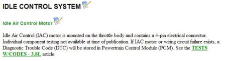

If once you get it moving down the road and it runs and drives okay, it is not a fuel pump or filter problem. I would look at the idle air control (IAC). This little unit is supposed to compensate for added engine load ie. in gear, AC, headlights etc. It may just have to be removed and cleaned with regular carburetor cleaner.
https://images.2carpros.com/forum/automotive_pictures/248092_caravan_1.jpg

I removed, cleaned, and reinstalled the idle air control (IAC) and the problem is unchanged. Is it possible or likely that it needs to be replaced all together or might it be something else?
I used the OBD system (i.e. turning the key ON OFF, ON OFF, ON and wait for the flashes) and got flashes 1, 2, 5, 5. According to my Haynes Repair Manual that MIL Code equates to codes 12* which is the battery disconnect within the last 50 key-on cycles (which i knew) and the other 55* description says "Completion of fault code display on Check Engine lamp." Which i have no clue of the meaning. I am at the end of my rope here and really annoyed and need a working car! Please suggest anything you can think of that i should check. Anything that even might be a problem that fits this issue.
Again if i get her to start in Neutral or park and keep the RPM's up above around 2000 plus and keep it there while switching into Drive i can get her moving. But (even while moving) if the RPM's are aloud to fall she chokes up and the engine cuts off (whether it be stopping, slowing down, or coasting)
