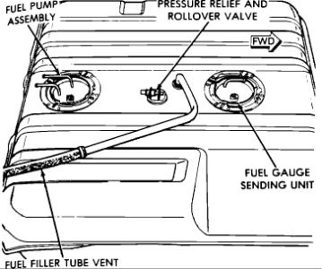

Where is the fuel pump located
Monday, January 25th, 2010 AT 10:29 PM
MECHANIC
75,992 POSTS
Fuel Tank Assembly
The fuel pump mounts inside the fuel tank, from the top of the tank. The fuel tank must be removed to access the fuel pump.
